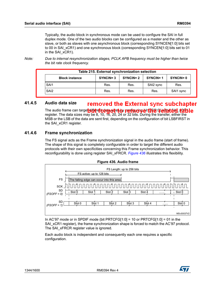

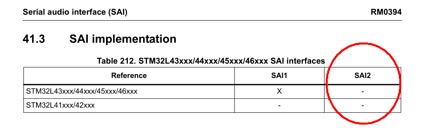

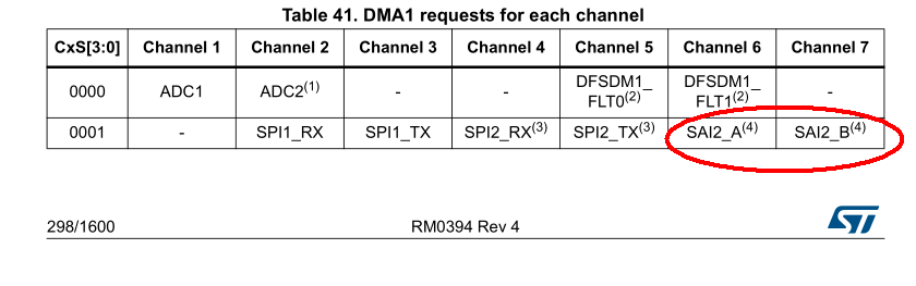

I understand that there's a great deal of copypasting when creating RMs, but can ST please pay more attention to the details?
In particular, no part described by RM0394 should have SAI2 implemented:
0693W00000VOMXEQA5.pngyet there are references to SAI2 through the document:
All I did was textual search for SAI2 (and yes, there's also the very confusingly named but existing PLLSAI2CLK signal).
