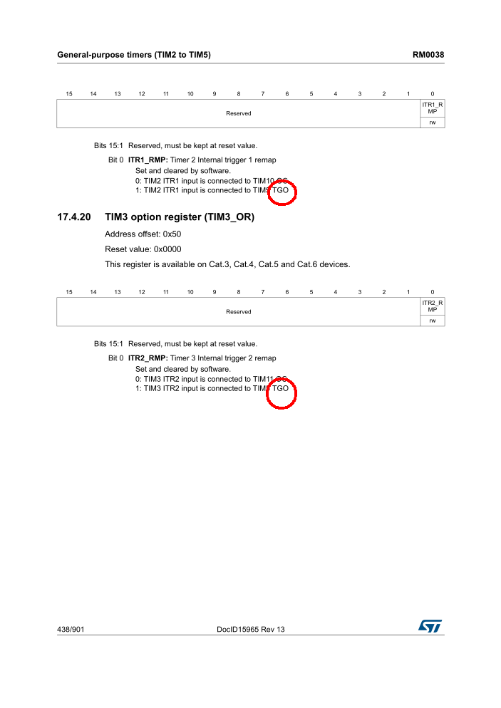

RM0038 TIM2_OR and TIM3OR: What is TGO?
waclawek.jan
Typo, or yet another internal signal name? I can't find "TGO" anywhere else in the manual by textual search.
4 REPLIES 4
Mike_ST
Well, I guess this is TRGO.
waclawek.jan
@Mike_ST​ ,
Yes, I guess that too.
But I post it here in the hope you (ST) will correct it, so that users don't need to guess.
@Imen DAHMEN​  ,
Thanks you take care of this one.
Imen.D
Thank you for your report.
I confirmed this typo. It should be TRGO in whole document.
Regards,
Imen
Thanks
Imen
