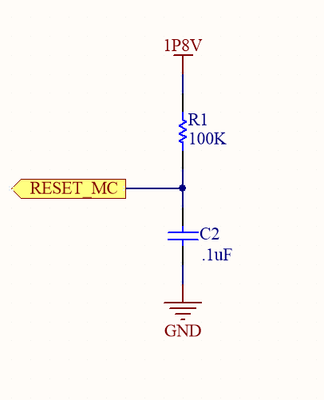

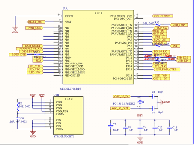

I am using STM32L072CZT6 for our low power application. We are using Standby mode with RTC for alarm and periodic interrupt wakeup. The device is wakeup and work properly for more than 12 hours hours. After that the controller didn't operate and we have to reset it externally (low pulse in MCU RESET pin). Even if we power off and ON the device it will not respond, we have to reset it manually. What will be the issue ?

Custom board? Show circuit. BOOT0 pin doing what?
The device has bootloader in 08000000 and program in 08001C00. There is no silent while(1) loops.
BOOT0 pin is connected to ground.
