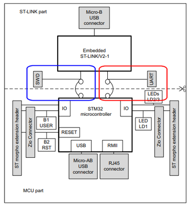

@SidneyCritic wrote:
Basically it has to be convenient to plugin a laptop in the car so you can adjust fuel mapping and data stream
You'd use a UART/COM port for that - not a debugger.
Addendum
This highlights the separate SWD Debug/Programming link (blue) and the UART link (red):
But they both go through the one micro-USB connection - in some cases, a mass-storage device also shares that one connection.
#STLinkUSB #STLinkVCP
