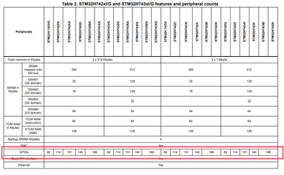

I am looking for the STM32H series part with more GPIOs and Timers than STM32H753ZI. Can you please suggest me some of the options in H series?
Below is my requirement
GPIOSPII2CUARTTimerCANInternal ADC Channel
6052216217

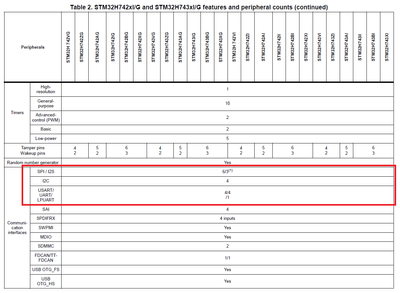

Hello @DJ7 ,
When you say STM32H, it could be STM32H5 or STM32H7.
Anyway, you can refer to the datasheet. For example in case of STM32H742xI/G /STM32H743x / STM32H753 Table 2: it shows all the instances available on the MCU.
For example for the GPIOs number, it depends on the package:
SPI/I2C/USART instances:
But becarefull, you need to check if all these instances could be used in parallel.

Hello @DJ7 and welcome to the ST Community.
For such a use case, I suggest you use the STM32-MCU-FINDER this tool where you could define what you want exactly, and the tool will give you all available options.
