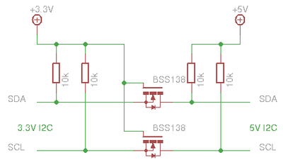

AScha.3
because you have cpu VDD at 2.5V , to be on the safe side, i recommend a simple standard level shifter:
So every chip works on its perfect level. (just your pullups to 2.5v and 3.6v , not 3 + 5V )
Be aware that the internal pullups need to be disabled in order for the pin to be 5 V tolerant. Otherwise, no issues.
Sco
Connecting directly may introduce the leakage, and a risk to damage the pin.
You can choose the right MOS to do a brief level shift or use a level shift IC.

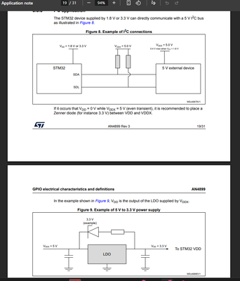

Magvel
@Sco @TDK @AScha.3 @ELABI.1 ,
I found this application note regarding the I2C implantation this is the diagram given. It describes the same application how we want to use.
https://www.st.com/resource/en/application_note/an4899-stm32-microcontroller-gpio-hardware-settings-and-lowpower-consumption-stmicroelectronics.pdf
They have also suggested a zener diode in case the if I2C rail powers up before the MCU power up can cause some issue but it seems it happen only if the I2C rail is above 4v of MCU rail(ex- MCU- 0v, I2C pullup- 4+v) in our case both rail powers at same time and its at 3.6v.
