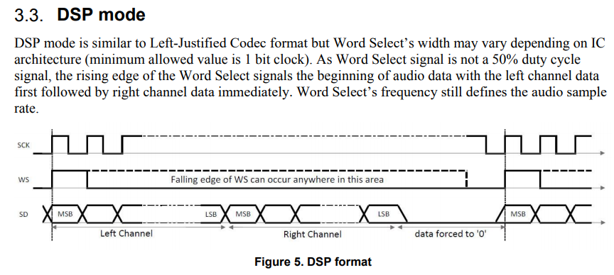

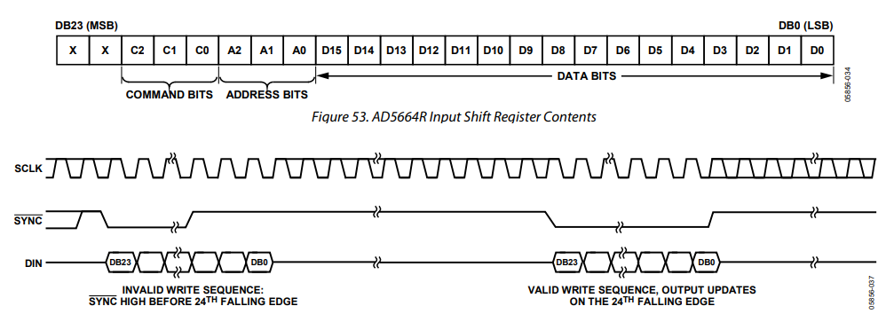

I have done some reading on the protocol. I'm not sure if it can be configured to be compatible with my SPI DAC? The main problem is that it is designed for audio channels / slots which are addressed by toggling the FS line over alternate whole words. The AD5664r requires a short toggle between words as per standard SPI, as attached.
With standard i2s I would need to have total of 25 clocks, with one extra clock for transition of WS. Or, toggle WS within less than 1/2 sck cycle and still reliably register the first bit of a word. The may work at low speed but it would be a poor attempt.
DSP mode looks more suitable but would I need to be sending extra padding bits at end of each word to allow time for WS to change? Or is it possible to set the WS period equal to data length in this mode? This would be ideal as looks like the protocol would assign just 1 extra clock cycle to allow toggling of WS while briefly forcing the data line to 0. I.e it would achieve 25 clocks with one used for WS. I have attached some documentation I read referring to this.
