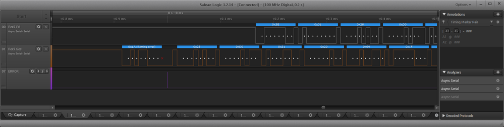

waclawek.jan
Posted on July 06, 2018 at 00:47
The DMA is to be used as a circular buffer/FIFO. At reception, NDTR represents the head pointer and a variable mainatined by the pulling software is the tail, the pulling software ought to pull until tail matches head (keeping in mind the various
https://community.st.com/0D50X00009XkhAxSAJ
of the DMA). As the UART is unfortunately not organized so that you can store/associate a particular byte with the FE, the best way is to purge the whole buffer, i.e. the pulling software, when recognizing the FE, should simply set tail to head. This of course assumes that there's either some framing/packeting in the UART data or some other possibly off-band framing (extra signal) present on which the communication can resume.

John Craven
Senior
Posted on July 06, 2018 at 01:11
I am using NUCLEO 446 RE board. I am using the HSE from the STLINK.
All the devices are sending the same frames at 125Kbaud.
i have checked the errors with a logic analyzer.
my logic analyzer sees the same framing errors when it tries to decode the frames.
When i check manually and automatically (logic analyzer), the baud rate is fine.
The framing errors are always at the beginning of each message 99% of the time.
Third trace purple is when i get the FE error interrupt.
First trace is good.
Second trace is missing about half of the 0x3E, 0x01 header,
The balance of message is synchronized.
I ran for days with the other two version of the device with no errors or issues.
Today i added tried the remaining device flavour and the errors occur.
I have tried 3 different unit of this version. The all have the same framing issue.
Pretty sure the issue is the one device variant.
Errors occur about once every 20s (about every 2000 messages or 88000 bytes)
And i am just going to have to figure out how to negotiate the errors.
