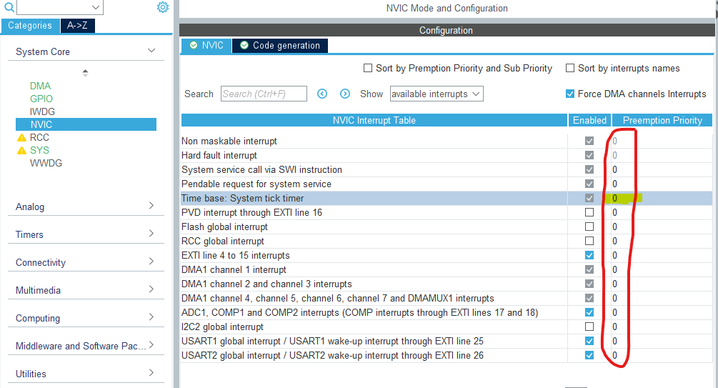

You can change the interrupt priorities for each interrupt. Right now they are all defaulted to 0.

I don't necessarily want to set the 1ms tick function to a higher priority than the audio routine. The audio processing is very runtime critical so having a fully independent timer variable I can simply reference would work a lot better.
I understand I could probably make the 1ms tick function just increment the global timer variable with no other processing, and do anything relying on the millisecond time base in the asynchronous loop, but this would be functionally the same as having a fully independent timer peripheral increment once per 1ms while also adding interrupt overhead to my program. Seems more ideal in the long term to set it up with the independent timer and not use an interrupt.

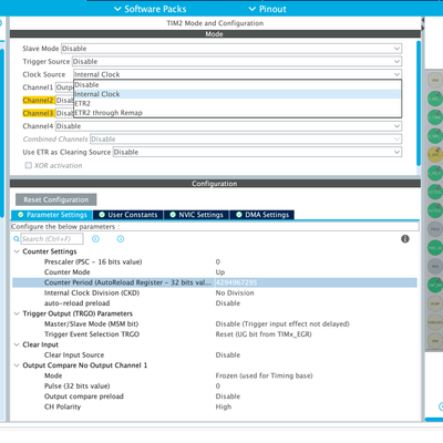

Could you divide down TIM2 or TIM5, via prescaler, so they free run at some rate you can use instead of SysTick?
The Prescaler is only 16-bit, but you might be able to select the clocking source, or APB dividers, to get you to around 64 MHz, that you could divide down to 1 KHz, and have HAL_GetTick read the TIMx->CNT ?

Is there an easy way to calculate the frequency or period of the timer? The options CubeMX gives for this are rather limited to say the least:

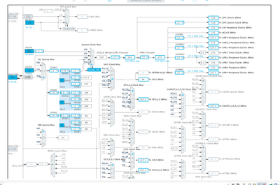

As you can see, I can select between 3 clock sources but there's no indication of what frequencies these are running at, also no indication of the eventual resulting frequency after the prescaler, the clock ui also makes it totally unclear which of the many internally generated clock values are being used as the "Internal Clock".
I also am unable to search for anything in the clock configuration tab, my only option is to squint at this super dense graph while looking for information that I don't even know will be there.
