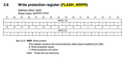

BTW, I am confused about the result of "HAL_FLASHEx_OBGetConfig(&OBStruct);", if the result as below:
  HAL_FLASHEx_OBGetConfig(&OptionsBytesStruct);
  LOG_DBG("current config: WRPState[%d]\n", OptionsBytesStruct.WRPState);   // 0
  LOG_DBG("current config: WRPPage[0x%08x]\n", OptionsBytesStruct.WRPPage); // 0xFFFFFFFF
Then, does that mean all the flash is WRP, or all the flash is NOT in WRP?
Thanks again for your help in advance.
FBL
Hello @Junde
Referring to PM0068, you can check write protection definition (0 for activated WRP).

@FBL Thanks for your help.
I was wrong about the meaning of the FLASH_WRPR bit.(0 is for active, NOT 1)
So my code should be as this:

Checking WRPState is useless, because this field is never set in HAL_FLASHEx_OBGetConfig() function:
void HAL_FLASHEx_OBGetConfig(FLASH_OBProgramInitTypeDef *pOBInit)
  pOBInit->OptionType = OPTIONBYTE_WRP | OPTIONBYTE_RDP | OPTIONBYTE_USER;
  /*Get WRP*/
  pOBInit->WRPPage = FLASH_OB_GetWRP();
  /*Get RDP Level*/
  pOBInit->RDPLevel = FLASH_OB_GetRDP();
  /*Get USER*/
  pOBInit->USERConfig = FLASH_OB_GetUser();
  /* WRPState was never set! */
You can only rely on WRPPage, RDPLevel and USERConfig fields.
WRPState is only useful when you set OBInit.WRPState to OB_WRPSTATE_EBABLE or OB_WRPSTATE_DISABLE and then feed OBInit to the HAL_FLASHEx_OBProgram().
