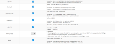

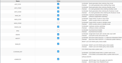

Does anyone have any idea what could cause this? We have the 100nF between nrst and gnd and our option bytes are as follows:

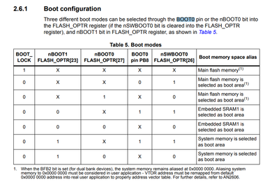

We're using the boot0 pin for FDCAN, so it isn't grounded. My understanding is that our boot configuration is taken from option bytes, not the state of the BOOT0 pin. I'm attaching a screenshot with nBOOT0 included (I realize that was clipped from my original post.
Looking (again) at the TRM, I think we have our option bytes configured incorrectly. We want nSWBOOT0 = 0 and nBOOT0 = 1. Can you confirm this is right?
From page 90 of RM0440:
