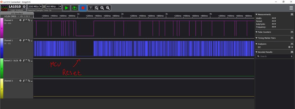

Using Nucleo-L476RG board with I2C. Using a logic analyzer i'm getting meaningless signals as seen in the image. SDA AND SCL are connected to pins PB11 and PB10 respectively and are connected directly to the logic analyzer block directly to monitor them. This pattern happens regardless of whether transmitting, receiving or idle. When zooming each pulse is a spike around 25ns and isnt related to anything.

What could be causing this potentially as I have used another Nucleo board and got the same result?

‎2021-08-05 5:27 AM
What do the signals look like on a scope?
What are you attaching the pins too?
Do you have pull-up resistors?
Common grounding?
Do you see this when you take the Nucleo out of the box, or just after you attach tings to it?
What does the schematic for the board indicate are connected to PB10/PB11 ?

‎2021-08-05 6:30 AM
The built-in pullups are not going to be sufficient for I2C communication unless you significantly slow down the speed.
If the pins function properly as GPIO outputs, probably what you are seeing is noise.
It also sounds like maybe you haven't actually initialized the pins as I2C. Perhaps your code never makes it to that point.

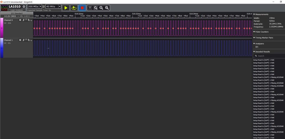

I've connected the pull-ups to 3.3V and it worked on another nucleo board (L476RG NUCLEO) but on the one my project is based on (F446RE Nucleo) it does not work. I've added 3.3V pullups but same issue. I then changed the pins to function as GPIO and toggle them and I got the same result meaning I2C is not the problem. I debugged line by line and discovered the behaviour happens after the clock configuration:

This is what I'm getting now: (Pins are connected straight to logic analyzer as GPIO without pullups).
The same square wave stretches the entire 5 second sample for both PB10/PC12
