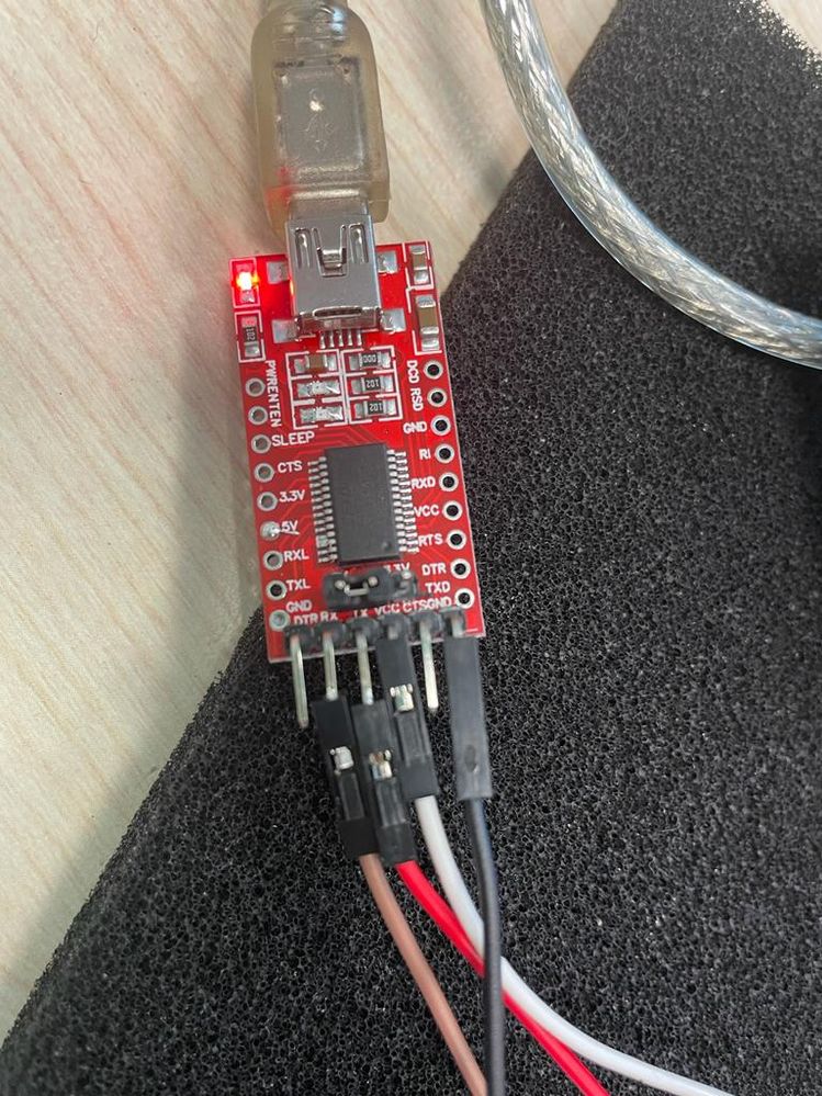

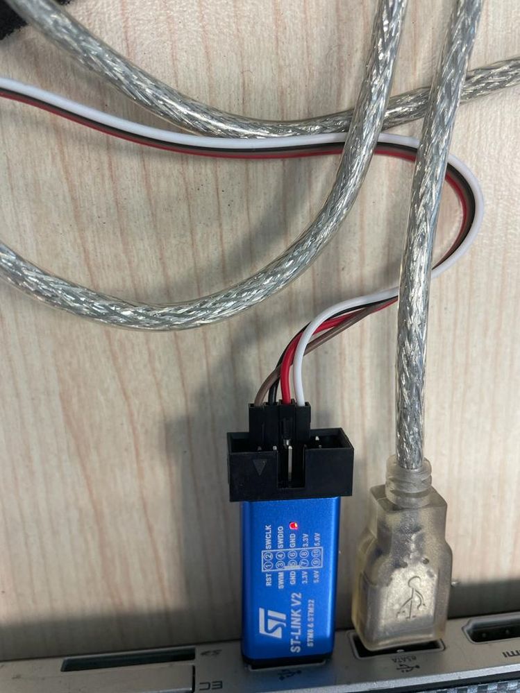

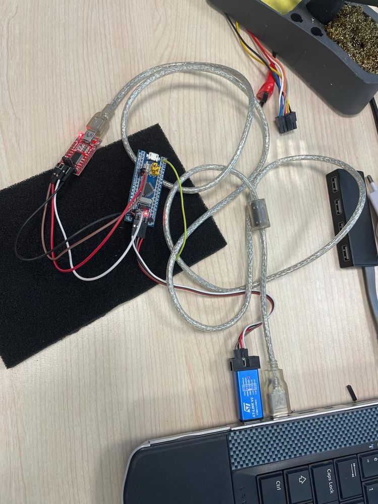

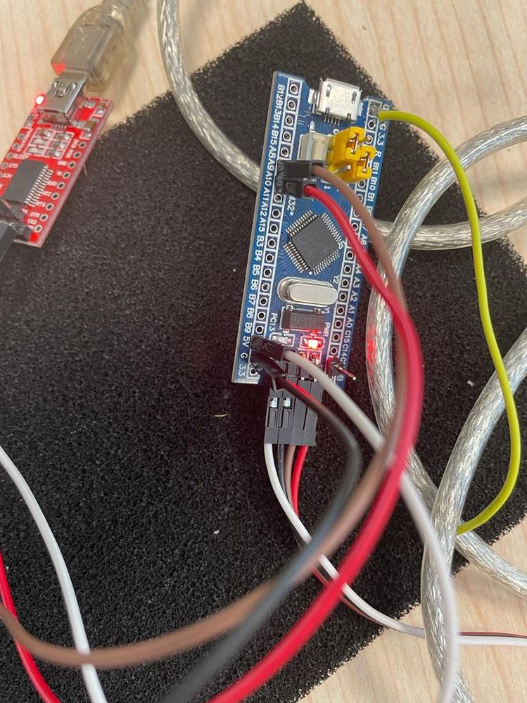

Nowadays I am trying to send and receive data with STM32f103C8 module. In fact, my aim is only write" Hello World " one after the other in the rows below at Tera Term, by coing at STM CubeIDE, and with my some hardwares. So , first I connected this STM32f103C8 module to an FTDI programmer module and ST-Link V2. By watching some videos, I connected these 3 products's pins:
STM32F103C8's Rx to FTDI's Tx,
STM32f103C8's Tx to FTDI's Rx ,
Ground to Ground,
STM32F103C8's 5V to FTDI's VCC pin, then, same legs of STM32F103C8's and ST-Link are connected to each other.

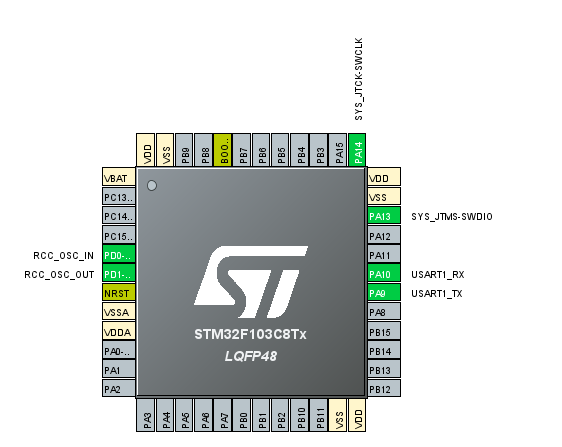

I used STM CubeIDE as developement environment, and Tera Term application to test it. When I build the project at STM CubeIDE, I get no error, but then When I Debug, then Resume(F8), there is no joy at Tera Term, and at STM CubeIDE a new page is openning named 0x1fffe61c which has explanation " Break at address "0x1fffe61c" with no debug information available, or outside of program code." inside this page.
Note : Baudrate is 115200 at both STMCubeIDE pinout configuration and Tera Term serial port settings.

2022-05-31 6:16 AM
The 0x1fffe61c address suggests it is trying to run from ROM, rather than your code in FLASH.
Make sure BOOT0 is LOW
Step the code, make sure it doesn't end up in Error_Handler()

2022-06-01 12:02 AM
My BOOT0 was High, bringing it to the LOW solved the issue, thanks for your answer @Community member . I wish you the best.:smiling_face_with_smiling_eyes:
And thans for other friends commended to my question.
