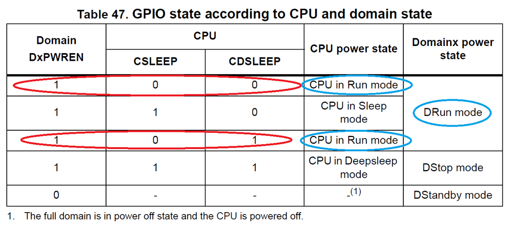

Questions about 'PWR - Monitoring low-power modes' on page 300 of RM0433.
nnie.1
Could anyone tell me why the same "CPU power state: CPU in Run mode" and "Domainx power state: DRun mode" have two different GPIO states which are on the page 300 of RM0433?0693W00000DmsYzQAJ.png
1 REPLY 1
The CDSLEEP bit is ignored unless CSLEEP=1. They could have condensed it into a single line.
