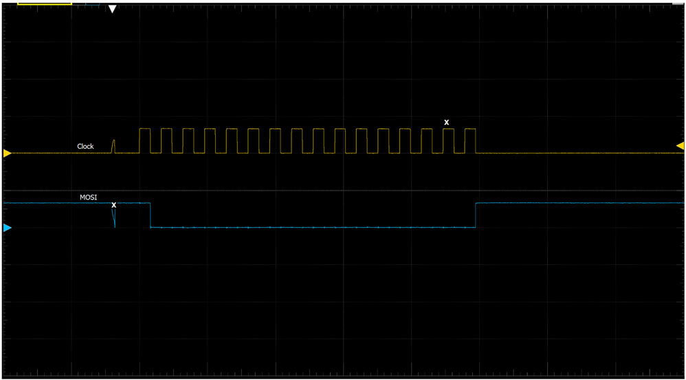

Case: 1 Data transferred: 0x1

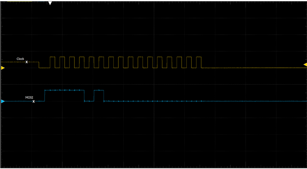

0693W00000JPooRQAT.pngCase :2 Data Transferred : 0x2F, Data Size(DS= 4)
0693W00000JPoobQAD.pngI have implemented the blocking call for SPI so far in my logic,

  1. In Case-1 I have set the DS size to 8 bits and my data is also of uint8_t why then is 16 clocks sent from the master?
  2. In Case-2 when the DS is set to 4 bits why are the bits after 4 bits sent(binary of 0x2F is 0010 1111)?

1+2) Show the actual code. You may be sending more data than you think due to data packing.

The number of sck clocks depends on data transmitted, even dummy one when need to read from slave.
A master sck clock is completed once the reception is complete, not transmit buffer empty which is to avoid pause between transmitted bytes. The fifo relaxes this further.
The fifo is sensitive to the core data bus, if you write 8 bit, 8 bit is queued, if you write 16 bit, 2x8 bit will be queued for the 8 bit spi.

Thank you for your inputs, based on it I found that the controller was writing 16bit to the SPI1->DR register. Earlier I had implemented it as
//8 bit transfer ,pTxBuffer = pointer to uint8_t
pSPIx->SPI_DR = *pTxBuffer;
Now It works when after typecast now the code looks like
*((uint8_t*)&pSPIx->SPI_DR) = *pTxBuffer;
Now the logic analyzer send out 8 bit when the data size is configured as 8 bits
@Community member​  If you are still figuring out why 16 clocks are sent out when the data size is set as 8 bit, this might be a possible solution
