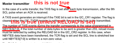

I'm studing I2C on stm32g071rb and I have a question about it.
In the datasheet there is this line: "In the case of a write transfer, the TXIS flag is set after each byte transmission, after the 9th SCL pulse when an ACK is received", but for the last byte TXIS remain LOW and TC become HIGH.
It's correct that for the last byte that I have to send via I2C, the TXIS bit remain LOW?
For example if I have to send(master to slave): 0x00, 0x01, 0x02
I set the CR2_NBYTES bit (3 << I2C_CR2_NBYTES_Pos)...etc
But after send the 0x02 byte, only TC is HIGH...so also the TXIS bit should be HIGH in this case?
What is "etc"? Details do matter, so post code and observed waveforms.

My code(sorry for code quality but  at the moment is only a test), I followed the datasheet flowchart(image in attach).
Do you think that I make some mistakes?
The slave seems to send an ACK at the moment.
I have 2 questions:
1) Sometimes at the end of the transmission, the TC bit remain low but I notices that if I put some delay before the TC check it work(as if I had to wait a certain time first, but in the flowchat I don't see this)
2) It's correct that for the last byte TXIS remain low?
Thanks a lot!
Simeon
I don't see that in the above code.
Try to step through it, reading out and printing/displaying I2C_ISR and I2C_CR2 after each relevant step; post resulting sequence.
waclawek.jan
March 6, 2024
OK I think I understand what is the source of your confusion. I believe the flowchart is not quite correct. We might've discussed this here before, I can't find that thread at the moment.
After storing the last byte to TXDR, it takes time until it gets transmitted. Only after the last byte gets transmitted is TC set.
Yes. Again, the narrative and the flowchart is not quite correct. The intention is, that TXIS is not indicator of "transmit register got empty" but "transmit register needs data"; the distinction is exactly that after the NBYTE bytes have been transmitted, there is no more "transmit register needs data" request.
