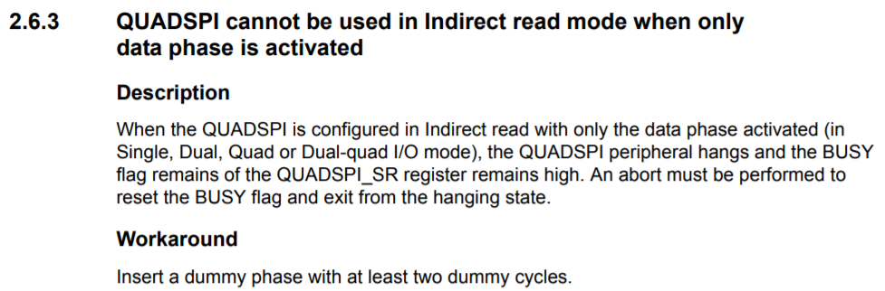

Check errata sheet ES0392, Rev. 6, 2.6.3.
alexborysevych9
September 25, 2019
Wow! Thank you so much for 100% accurate answer! Now it is clear.
I will leave it here for the future:
