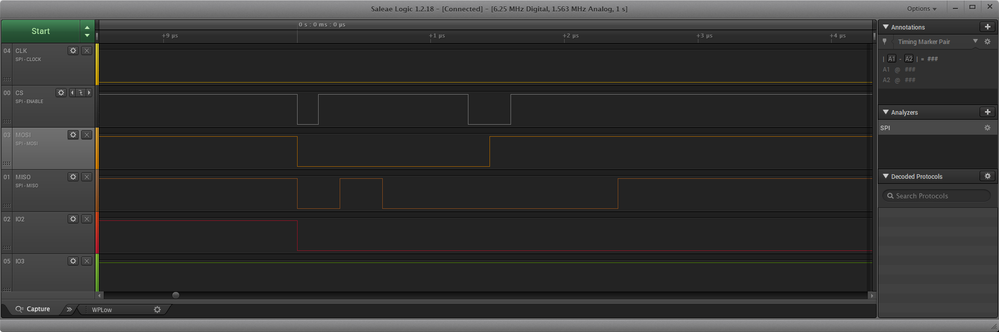

Ok, now i'm really confused. Connected up my Saleae logic analyzer to the flash chip and two things immediately stand out to me:
  1. I don't see the CLK toggling. I don't know how the other signals are showing negative edges at the same time without a clock. I've checked my wire lead to the flash and looks well soldered... but the code seems to be calling the functions to enable the QSPI clock in the HAL_QSPI_MspInit, so clock should be running.
  2. IO2, which is active low Write Protect, goes low and stays low. So I can see how it is getting stuck in QSPI_WriteEnable(hspi). IO2 and IO3 both have 10K pull-ups externally connected to them.
Since MX_QUADSPI_Init runs without hitting the Error_Handler(), I'm expecting my QSPI clock to be running from that point. Is this an incorrect assumption?
Thanks

for write enable command after which I called AutoPolling function.
>>Can we replace this with simple reading Status Register and check that required bit?
Yes, the hardware provides for a great deal of flexibility in how you interact with it, the functions here supposedly provide an optimal way, but not the only way.
Some memory devices permit a continuous stream to be read from the same register, others might not, you'd need to check the datasheet for the specific parts involved.
