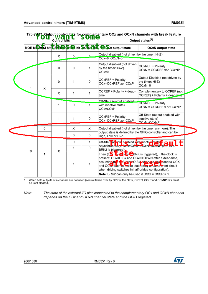

When I trying to run PWM on PA8 I get no PWM at all. The pin just goes high and I can't understand why. I used HAL example code. The cpu is running at 16 MHz and here is the code

Read out and post content of relevant GPIO and TIM registers.
TIM1 is Advanced timer, did you set TIMx_BDTR.MOE?

Can you clarify TIMx_BDTR.MOE?
I was lazy to locate the RM for your particular chip, but the timers are much the same.
