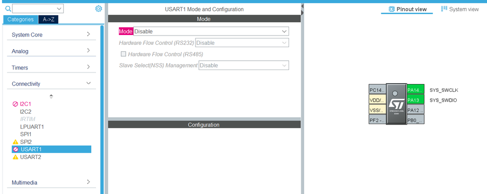

I am interested in the following question: is it possible to use the pins of the STM32G031J6M6 microcontroller first for programming (SWCLK, SWDIO), and then for another functionality, for example for UART?
Maybe there is some separate programming mode and a separate functional mode? Or for example, do I need to use Reset to perform programming? I know that the PIC10 microcontroller uses the same pins for programming and performing functions.

If you don't commit a pin the NRST, you'll either need to power cycle the part, or facilitate it reseting via some user interface or user interaction via your UART
I might suggest putting an idle loop in Reset_Handler to burn a few hundred thousand cycles to allow time for the debugger to probe/connect out of power-up/reset before you get to main() and reconfigure the SWDIO/SWCLK to alternate functionality or different bond-out pin usage.
Yes, this is possible. However, if the pins are defined as UART you will be unable to connect over SWD. This also means debugging with SWD will not be possible. Ensure you are able to enter the bootloader or recover the chip in some other manner. Inserting a 1sec delay on startup before re-assigning the pins can work, if you are quick with connecting.
The option with a delay at the beginning of the program sounds good.
Is it possible to perform the first firmware via the SWD interface, and then when the pins are marked for UART, flash via the UART interface?
> Is it possible to perform the first firmware via the SWD interface then when the pins are marked for UART, flash via the UART interface?
You'll have to get into the bootloader if you want to use the UART interfaces supported by the bootloader. There is no way to run the bootloader for 1 second, then fall back to running the application if nothing responds.
