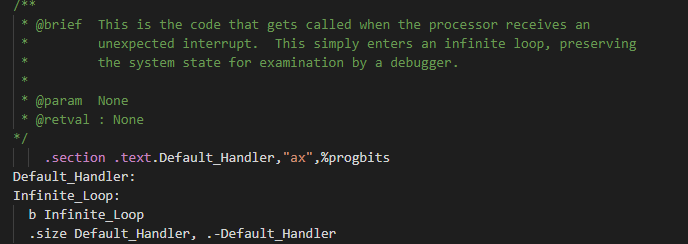

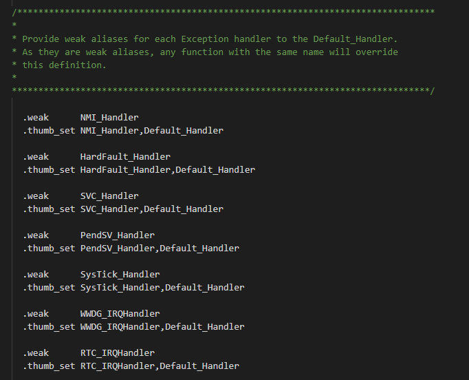

all handlers are defined as weak functions which default to an endless loop. If you do not override the handler this will default to it. This is usually in the toolchain specific assembler startup code.
These snippets for example come from the startup_stm32f030x6.s file for gcc created with CubeMX.

But I did overwrite the handler(please see my code line 133-143). The name of the function I overwritten is 'HardFault_Handler'. The code still doesn't go there. It stays in the main program loop even if the interrupt request was triggered.
Also about your remark about the infinite loop. The dummy handlers are indeed infinite loops. But if the hard fault exception triggers shouldn't the code go to there(in the startup code to the dummy handler)?
In lines 133-143 you overwrote the HardFault_Handler, not the EXTI0_IRQHandler (as stated, you commented it out).
Your assumption "If I understood correctly the a hard fault exception handler should catch all exceptions that do not have a specific handler" is not correct. If you do not implement a given handler, you will end up in the default handler of that given exception which happens to be a tight loop.
