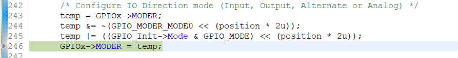

It appears to me that the MCU resets itself. I attached twi scope images of the nRST pin of the CPU. I also connected a GPIO output that is switched on just before the initialisation of PG10.
The first image shows the situation without the crash (The nRST is not connected in this image) The second shows the situation with the crash. You can see that voltage of the GPIO output immediately drops. After 400 mS the CPU resets itself.
The crash occurs when the rigoster MODER is written. In this situation MODER10 is changed from '3' to '1'.

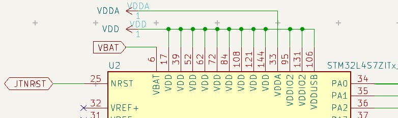

Sorry for keeping you Buzzy. The PG10 has a capacitive coupling with the enable signal of the LDO. When the PG10 is configured as an output, it causes a smal glitch at the EN input, causing to power supply to drop for a short moment. Enough to have the CPU to restart. oeps...
