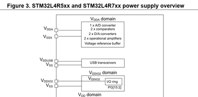

On the L4+ the VDDIO2 on GPIOG bank must be explicitly enabled
    /* VddIO2 must be enabled to access GPIO port G[2:15] */
    __HAL_RCC_PWR_CLK_ENABLE();
    HAL_PWREx_EnableVddIO2();
    __HAL_RCC_GPIOG_CLK_ENABLE();

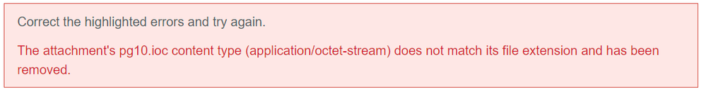

Hi David,
Thank you for your reply. I'd love to send my .ioc file. But the site refuses to accept it.
Has anyone a solution?

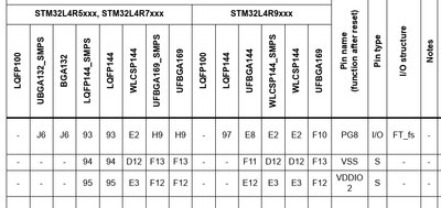

I'm sorry, but i cannot find how to enable the VCCIO on GPIOG bank. Could not find it in any manual. So a hint would be apreciated.
Regards,
Geert
from p.  24/307  -> DS12023 Rev 5
did you connect vddio2 -> vdd
