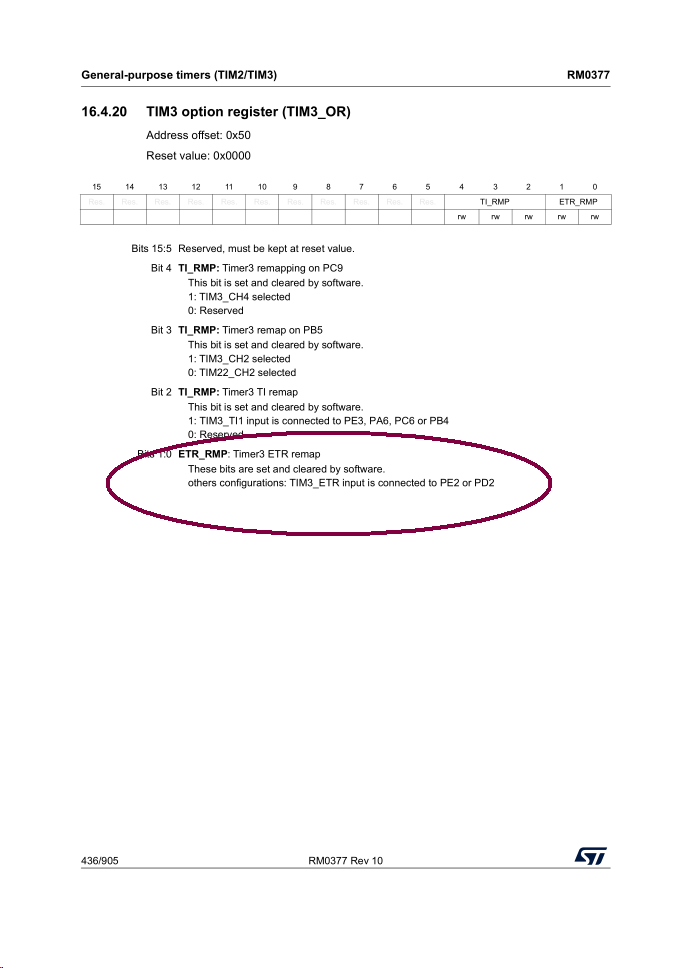

Problematic 'L071 TIM3_OR3 bitfield description
waclawek.jan
0693W00000aIkBoQAK.pngThis description is copy/paste from the description for 'L073/'L072 and the only relevant setting value was simply deleted - in the 'L071, there is no HSI48. In this way, this description makes no sense.
That deciding to have separate RMs for the three 'L0x1/2/3 variants was a bad idea to start with, is another thing; but I unfortunately don't believe ST has the willpower to revert that.

Hello @Community member​,
Thank you for having reported the point.
I will escalate this feedback internally to the STM32L0 Owner to take the necessary action.
An internal ticket is submitted ID: 147423 (PS: This is an internal tracking number and is not accessible outside of ST)
