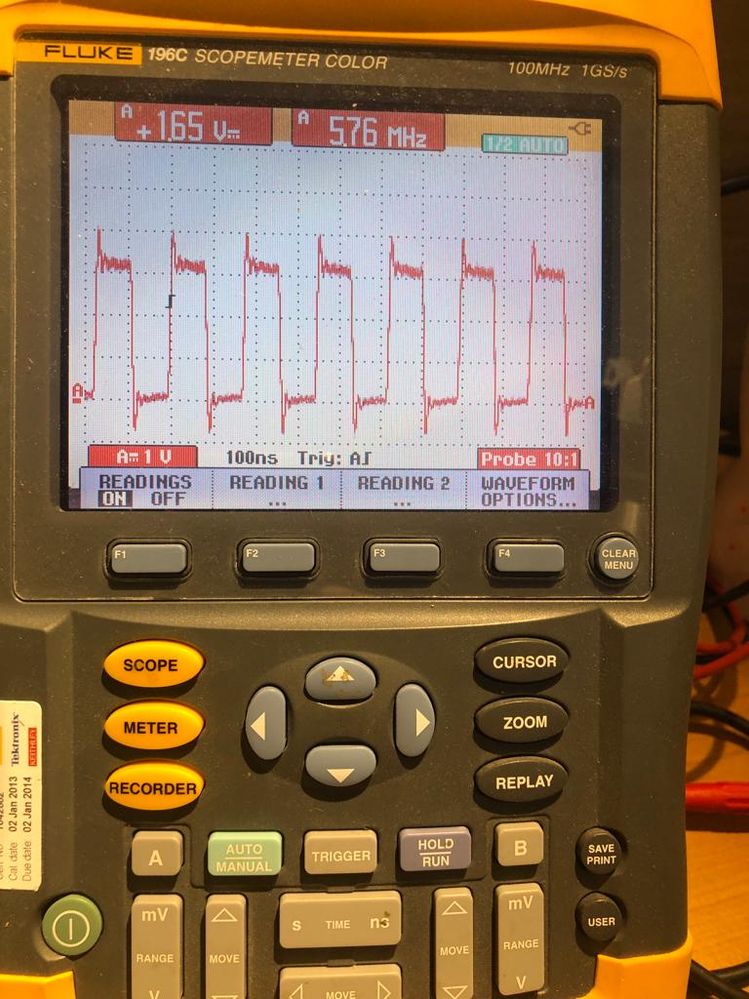

Hello @Arnaud​,
As @Community member​ mentioned, the proper way to check the HSI frequency is to enable the MCO output and check the frequency in oscilloscope.
Even with a wrong calibration, HSI doesn't drift out of 30%.

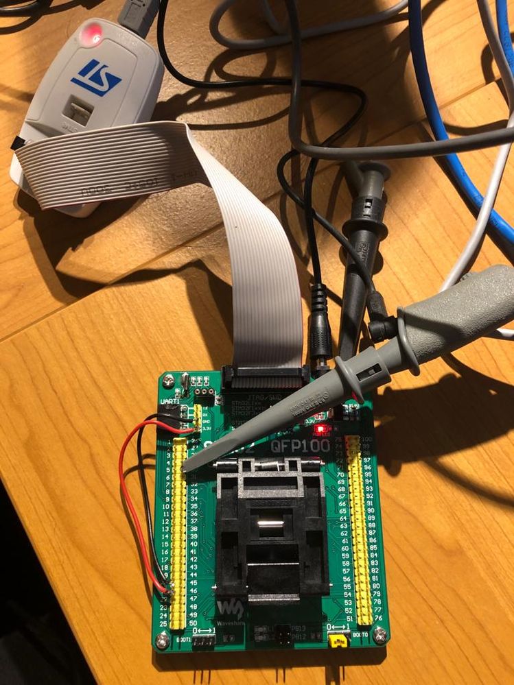

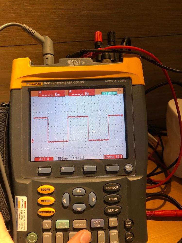

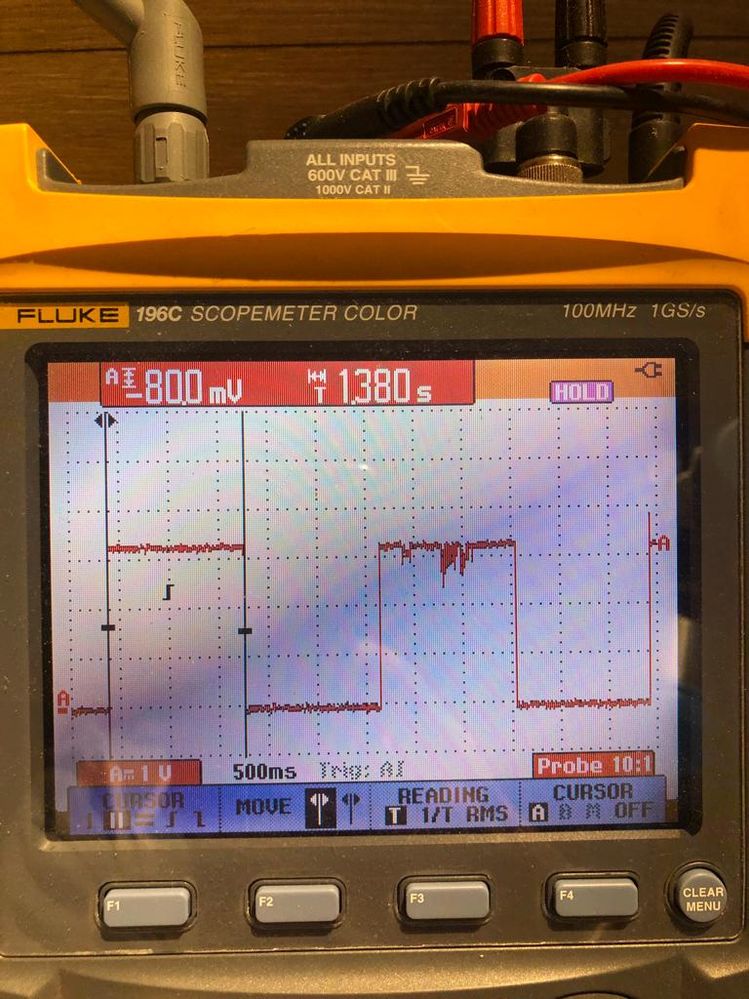

I have tried, I have the same problem. I have configure an output to see the timer, the toggle is set at 1000 ms, I can see that there is still a delay for about 30%. Please see the pictures below.

Hello @Arnaud​,
If you want you can do it by CubeMX.
First create a new project in CubeMX. Then , in RCC tab under System Core, check the box "Master Clock Output" (to enable the MCO pin).
After that, go to Clock Configuration, on MCO source Mux, please select HSI source. You should see that PA8 configuring as RCC_MCO.
After generating the code, HSI will be available on PA8. You can display it on oscilloscope and measure the frequency.

In your code :
htim6.Init.Prescaler = (uint32_t)(SYSTEM_CLOCK_ALFANO / 10000) - 1; // (uint32_t)(SystemCoreClock / 10Khz) -
//permet davoir le timer avec une base de temps de 0.0001 seconde
This is not right: as SYSTEM_CLOCK_ALFANO is 8000000, you get 800Hz, not 1000Hz
As you get 1.38s instreed of 1.25s I thing your HSI is 7250000 Hz.
