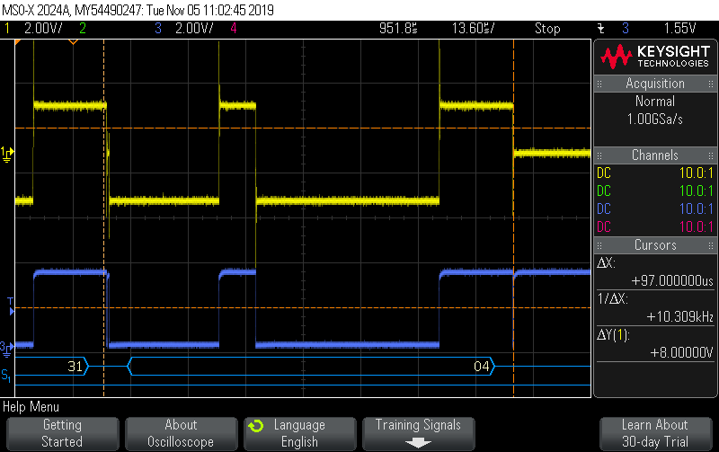

Problem is solved when I put termination resistors in the stard and end of the bus but when I do not do I have a strange behavior of the MCU that I cannot explain/understand.

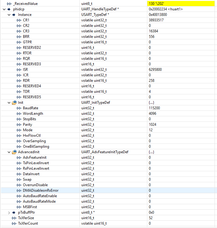

Below you see the screenshot of Yellow: RS485 bus, Blue: The RX Line on the MCU.
This is a 115200 Baudrate, Even Parity, 1 Stop Bit, 8 bit communication.
All the bytes are translated correctly every time (10mil messages exchanged) BUT the very last one sometimes it is not interpreted correctly.
You see that the oscilloscope finds this message as 0x04 or 0b00100000.
The MCU finds it 0x82 or 0b01000001. I looks like shifted by one bit to the left, including its parity bit.
I consider that this is caused by the glitch at the end of the message.... but if you see this is after the stop bit! So I do not really understand this behavior...
I am not using DMA, this is a byte by byte reading, and a quick interrupt handler.
It is true that the overrun flag is triggered but I cannot really tell why..
This is when the last byte is not received properly
This is when the last byte is received properly.

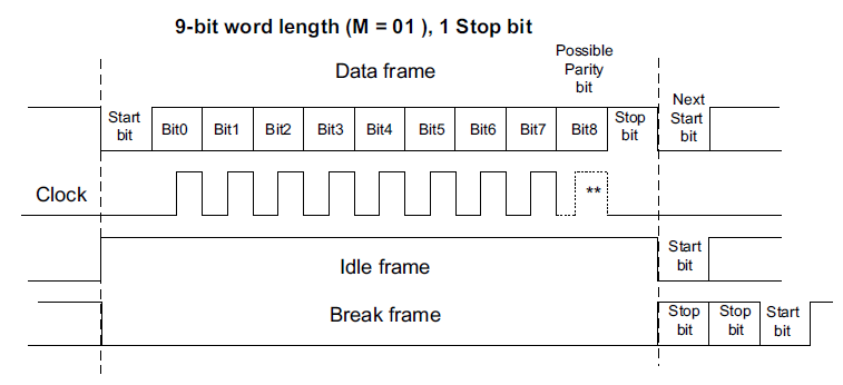

So my main question is...

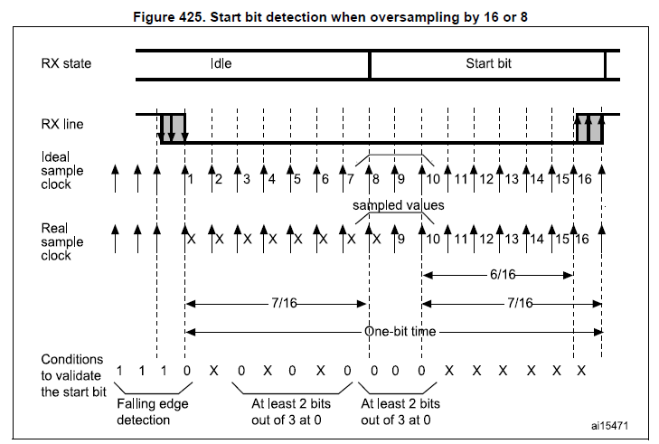

Since this is coming from the datasheet of the MCU:
Why something in the Next Start bit which is clearly not valid is overwriting my message creating an overrun error?

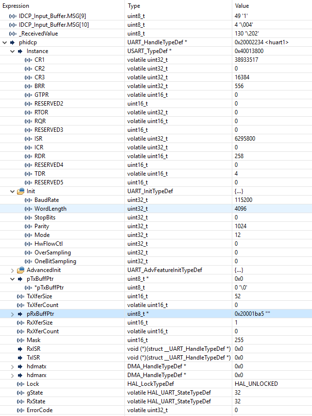

The Code was stripped down to the following to find it again when it happens:
void HAL_UART_RxCpltCallback(UART_HandleTypeDef* huart)
if(huart->Instance == USART1)
uint8_t _ReceivedValue = IDCPrxbyte; // Get the Actual Received Value
if(_ReceivedValue == 0x04) // Received End of Transmission Message
// Enable a GPIO
else if(_ReceivedValue == 0x82) // Received End of Transmission Message
// Enable another GPIO
HAL_UART_Receive_IT(phidcp,&IDCPrxbyte,1);
I would not expect that this would consume any time..... But it still happens!

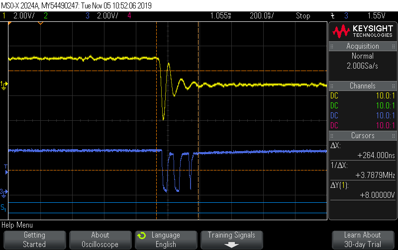

My Question how can it be any valid frame if the graph below is showing the following
The Glitch Duration is as shown below:
This is 264ns.... the duration of each oversampling 16 is already double 562ns and it needs to find a few to identify this is an actual start bit...
Am I seeing something wrong here?
Additionally if I connect an FTDI 3.3V to USB I do not see any additional messages reported by the PC Serial Port and the message is interpreted correctly (I understand that the MCU does not have a Buffer / FIFO but at least it confirms that the proper message is sent in the BUS and my PC Serial Port does not see the "additional messages" the MCU sees in the bus)

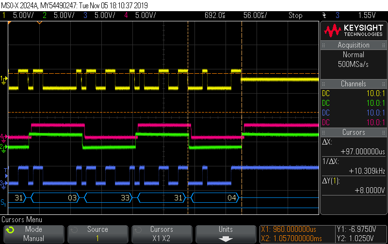

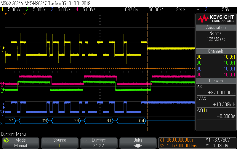

Some Additional Information.
I added two debug Points for the Interrupts ( Green & Pink Signals )
Yellow: The RS485 Bus
Green: void USART1_IRQHandler_TX_RX(void)
Pink: void HAL_UART_RxCpltCallback(UART_HandleTypeDef* huart)
Blue: Rx
Scenario with the glich[Problem on Last Measurement]
Scenario without the glich[Correct Information]
What you can see over here is that the interrupt when I have a glich is happening much later than when there is no glich.
I want to believe that there is a configuration I have is wrong but for the moment I do not know where shall I look into.
The Start Bit, the Data the Parity and the Stop Bit are all there and there is a glich ... so why the original message is shifted? Looks like the timing is not very well respected or I do not understand something in the manual.
