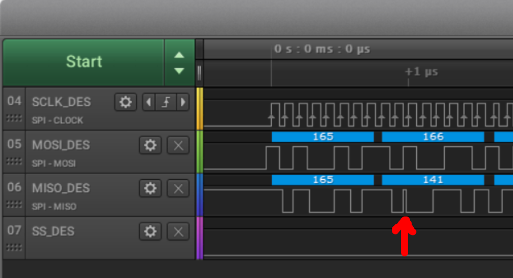

first of all thanks for the fast answer and sorry for beeing not so specific in my problem description. I try to be more specific now.
Please see attached screenshot of an SPI trace I captured just now. We see on the MOSI that the data is send as an incrementing counter starting @165 counting upwards. The second screenshot attached shows the internal buffer after receiption.
Now I have two problems on slave side:
1.) Slave-Rx: The data as you see in the variable "rx_data" in the 2nd screenshot is not fitting to the MOSI line shown in the trace screenshot (the first byte is correct, while the second which is actually 0xB3 should be 0xA6.
2.) Slave-Tx: The "tx_data" as visible in the screen is the same counter starting @0xA5, however in the screenshot we see that the data is not correctly shifted out on the MISO line.
Also please have a look at attachment registers.png to see the SPI registers after transmission (of 1024 bytes) is complete.

‎2020-08-21 1:02 AM
‎2020-08-21 1:02 AM
‎2020-08-21 1:18 AM
Please also note that if I put a spacing (delay) in between the bytes on the MOSI (i.e. I dont send it using DMA on the master side), the data is properly received and transmitted back on the slave side. See attached screenshot as well. The problem only seems to occur if there's no (long enough) space in between the bytes being send on the MOSI line.
‎2020-08-21 6:56 AM
Looks like your slave signal sees an extra pulse during the second byte.
Can you take an analog capture with sufficient bandwidth?
Does the problem still occur if you slow down the clock but still use DMA?
