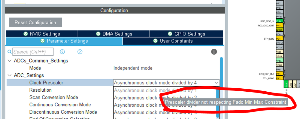

In CubeMX I am unable to select the DIV1 option. I can change it to DIV1 only by manually editing the generated code. This is it bit tedious as I have a complex set-up in CubeMX. The "STM32H7743ZITx" should of course be "STM32H743ZITx".

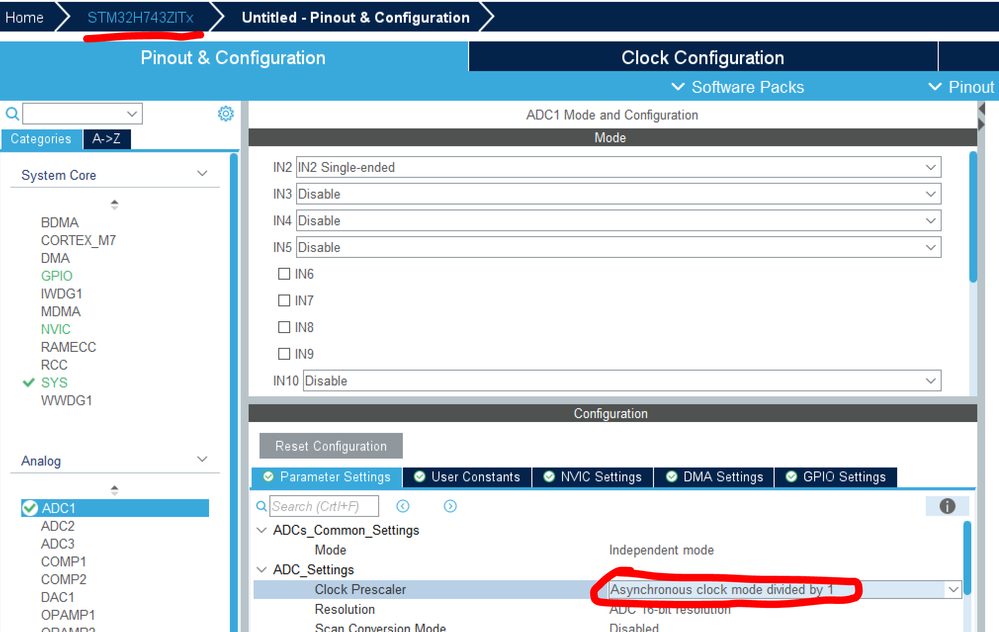

No such problem here:

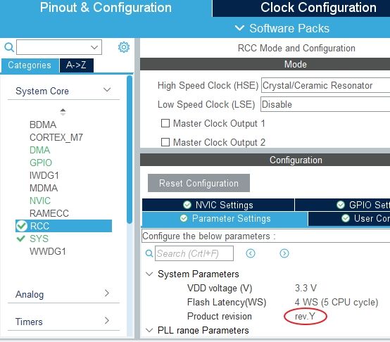

Check if​ rev.V option is selected. Revision selection list is somewhere in System core settings of STM32Cube configuration tool.

Thanks for the suggstion. I looked but did not manage to find the rev. V option in the System core settings. Maybe I am looking in the wrong place

CubeMX will tell you the problem if you hover over what is grayed out.

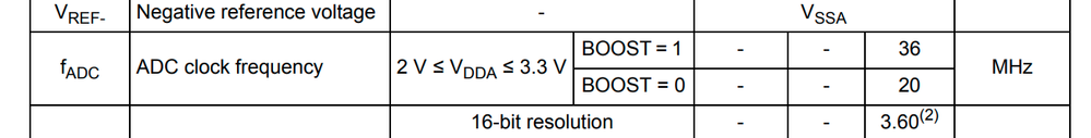

The datasheet specifies a max ADC clock of 36 MHz, provided BOOST=1.
Since your ADC input clock is 40 MHz, a divider of /1 would violate this.
Your project has BOOST=0.

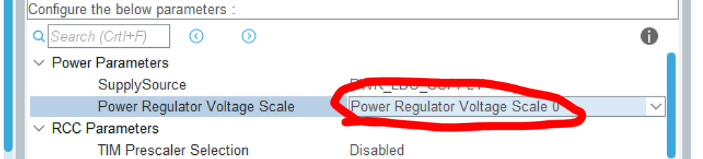

If you want max ADC clock, set BOOST=1 by selecting voltage scale 0, the change your ADC input clock to 36 MHz, then select the /1 divider.

0693W00000D1AW1QAN.jpgSystem core → RCC → System parameters  → Product revision
