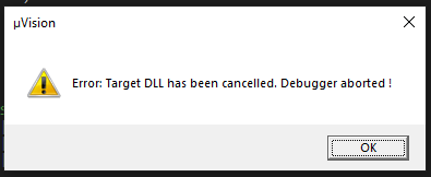

I am developing on the STM32H7B3i-DK board using Keil MDK + STMCubeMx for creating the project.
For some bizarre reason that I can't explain, I can no longer do debugging on my dev board after been blocked for a few days by an issues that I had with "option bytes".
Now the option bytes issue was resolved I tried to continue with my debugging only to discover that I can not longer do debugging on the board which was kind of working.
Every time I run the debugger it seems to crash in the following function. The value passed in the SupplySource parameter is PWD_LDO_SUPPLY.
HAL_StatusTypeDef HAL_PWREx_ConfigSupply (uint32_t SupplySource)
/* Set the power supply configuration */
MODIFY_REG (PWR->CR3, PWR_SUPPLY_CONFIG_MASK, SupplySource);
Once the code tries to execute the line MODIFY_REG(PWR->CR3, PWR_SUPPLY_CONFIG_MASK, SupplySource) it crashes with the following dialog box message
At which point I can no longer continue with the debug session other than to power cycle the board or else I start to get other error messages such as
Followed by
Are other experiencing issues with this board. So far I have used the STM32H750, STM32H743 and the STM32L073 without any issues.
