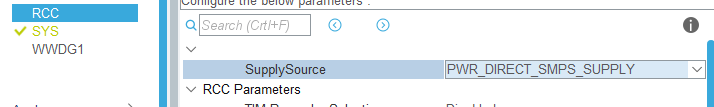

I am developing on the STM32H7B3i-DK board using Keil MDK + STMCubeMx for creating the project.
For some bizarre reason that I can't explain, I can no longer do debugging on my dev board after been blocked for a few days by an issues that I had with "option bytes".
Now the option bytes issue was resolved I tried to continue with my debugging only to discover that I can not longer do debugging on the board which was kind of working.
Every time I run the debugger it seems to crash in the following function. The value passed in the SupplySource parameter is PWD_LDO_SUPPLY.
HAL_StatusTypeDef HAL_PWREx_ConfigSupply (uint32_t SupplySource)
/* Set the power supply configuration */
MODIFY_REG (PWR->CR3, PWR_SUPPLY_CONFIG_MASK, SupplySource);
Once the code tries to execute the line MODIFY_REG(PWR->CR3, PWR_SUPPLY_CONFIG_MASK, SupplySource) it crashes with the following dialog box message
At which point I can no longer continue with the debug session other than to power cycle the board or else I start to get other error messages such as
Followed by
Are other experiencing issues with this board. So far I have used the STM32H750, STM32H743 and the STM32L073 without any issues.

‎2020-09-02 6:13 PM
Hello Onio,
From UM2569 page 17, the board is designed for SMPS only as default config which mean you need the SMPS enabled.
By using LDO_SUPPLY you are enabling LDO and disabling the SMPS thus you have no 1.2V supplied to the core and your debugger connection crash.
Try "PWR_DIRECT_SMPS_SUPPLY" or change it in your CubeMX project withing RCC parameters (see attached).
Hope my suggestion help.
Hajji.

‎2020-09-03 2:21 AM
Hi M.Hajji,
Thanks your suggestion definitely helped. Yes it was the power supply setting issue. The only bit I need to figure out was why it seemed to have worked last week.
At least for now it is sorted so I can press on again. Thanks
