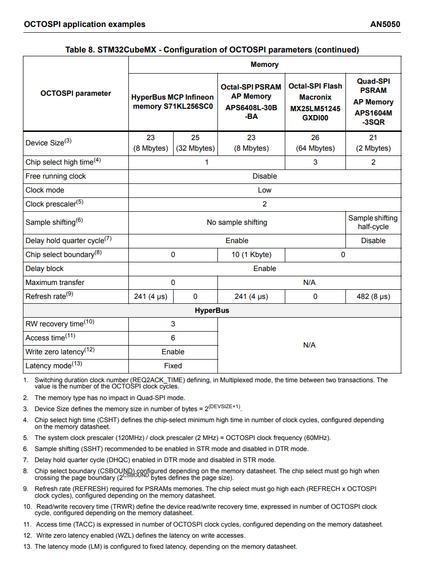

The main OCTOSPI settings are
#define OCTOSPI_DEVICE_SIZE 23
#define OCTOSPI_FIFO_THRESHOLD 4
#define OCTOSPI_FIFO_CLOCK_PRESCALER 4
#define OCTOSPI_CHIP_SELECT_HIGH_TIME 8
#define OCTOSPI_TRANSFER_RATE 250
#define OCTOSPI_HYPERRAM_RW_RECOVERY 3
#define OCTOSPI_MAX_TRANSFER 0
#define OCTOSPI_HYPERRAM_LATENCY 6
The OCTOSPI mux clock in 200MHz

Is the delay block enabled or disabled?
Could you please refer to AN5050 table 8. and check your OCTOSPI configuration.
Please take a look at Help needed for tuning 64Mb HYPERRAM (S27KL0642DPBHI020) on STM32H735IGT6 discussion may help you.

Thank you for your suggestions. We have tried to use the information you provided to adjust the HyperRAM settings to no avail.

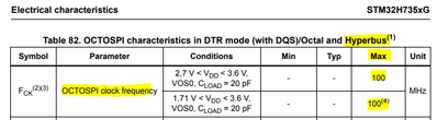

For more investigation could you please share your project and the memory datasheet?
Also could you please try to decrease the OCTOSPI frequency:
Thank you.
Kaouthar
The device we are using is: https://www.infineon.com/dgdl/Infineon-S27KL0642_S27KS0642_3.0_V_1.8_V_64_Mb_(8_MB)_HyperRAM_Self-Refresh_DRAM-DataSheet-v09_00-EN.pdf?fileId=8ac78c8c7d0d8da4017d0ee8a1c47164
I will try reducing the frequency, however we are not using either PC2 or PC3 for the interface
