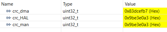

perhaps someone here has an idea what's going wrong:
I wrote a small program with cube ide to calculate a crc32 (standard polynom 0x4c11db7). It took me some time, but now I get the same result when using HAL_CRC_generate and 'manually' feeding the  CRC module.
Then I tried to feed the CRC module via DMA (GPDMA, channel 0), and then it becomes a little bit weird:
if the length of data is 1 to 3 bytes, all three methods calculate the same crc.
But if the length is >= 4, the crc generated via dma differs.
Attached is the main.c, but the interesting code of initializing the crc module and the dma channel is listed below...

When computing the crc32 over the first 3 value, I get
CubeVar3CubeVar3
The crc32 over the first 4 values gives the result
CubeMem4CubeMem4

> HAL_DMA_Start(&handle_GPDMA1_Channel0, (uint32_t)&testdata[0], (uint32_t)&CRC->DR, crclen);
> crc_dma = hcrc.Instance->DR ^ 0xFFFFFFFFu;
Are you waiting long enough for the calculation to complete? HAL_DMA_Start only starts the process. Perhaps insert a delay between those statements. Seems unlikely to be it, but it would explain things.

Hello TDK,
that was indeed the problem.
After introducing a callback for DMA complete
handle_GPDMA1_Channel0.XferCpltCallback = DmaCompleteCallback;
where a flag is set
volatile uint8_t dmaFinished = 0u; void DmaCompleteCallback(DMA_HandleTypeDef* hdma) { dmaFinished = 1u; }
and starting the calculation with HAL_DMA_Start_IT(...) (followed by a while loop waiting for flag set...)
handle_GPDMA1_Channel0.XferCpltCallback = DmaCompleteCallback; dmaFinished = 0u; HAL_DMA_Start_IT(&handle_GPDMA1_Channel0, (uint32_t)&testdata[0], (uint32_t)&CRC->DR, crclen); while (!dmaFinished) { ; } crc_dma = hcrc.Instance->DR ^ 0xFFFFFFFFu;
 it went smoothly :)

The interesting thing in this is, that 0x83DCEFB7 is CRC of only 1 byte, 0x31. So how comes that when the same sequence is used on 3 bytes, the result is correct...
