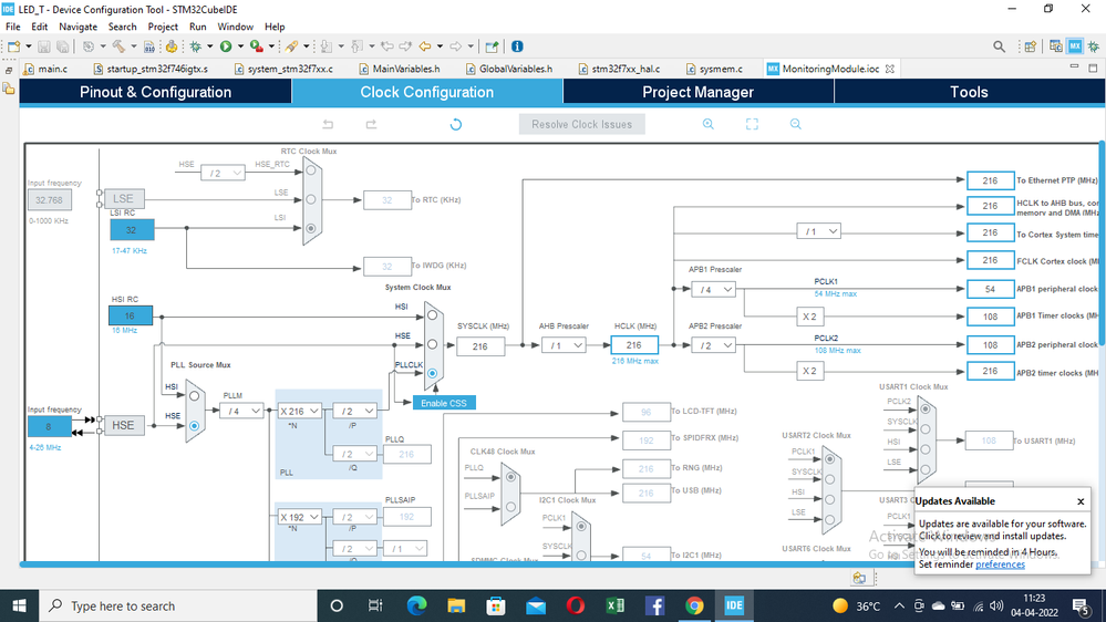

‎2022-04-03 11:34 PM
Timer clock frequency : 216Mhz
Generated Frequency: 32khz
Timer is 16 bit.
Target resolution is 0.02%.
‎2022-04-04 7:51 AM
0.02% is 5000 timer clock for 1 PWM period.
For a PWM frequency of 32K and 5000 clock/period you need a timer clock of 5000*32K=160 Mhz
So a would use:
Timer prescaler: 0
ARR = 216000000 / 32k = 6750 - 1
So a PWM at 32 KHz and a resolution of 1/6750 = 0.015%
