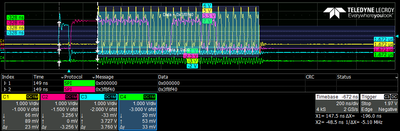

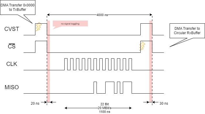

I need to implement a protocol for an external ADC. An SPI read with 22 bits should be triggered via a timer in a 4us cycle.
My procedure:
- TIM2 triggers a DMA transfer from the TxBuffer into the SPI->TXDR (with some zeros)
- Since CSTART is set and TSIZE is set to 0, the frame is immediately (approx. 196 ns delayed) written to the SPI bus
- The received data should now be written to an RxBuffer via DMA
- With DMA half complete or complete (after 125 samples in each case), an average value is to be formed.

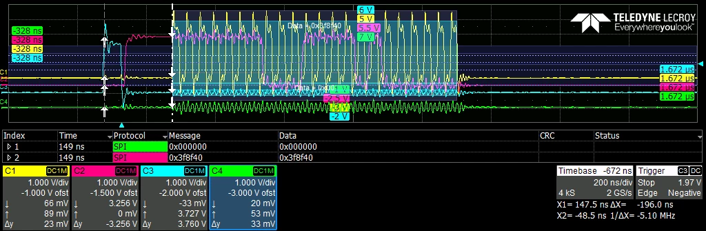

The protocol on hardware side is working fine:
My problem now is, that the DMA half complete or complete callback is never called (I used HAL_SPI_RxHalfCpltCallback and HAL_SPI_RxCpltCallback and overwrote them in the main). I have already read through some forum posts, the SPI seems to be a real pain. At least the write is now working via a DMA request from the timer, can anyone help me to get the read working?
