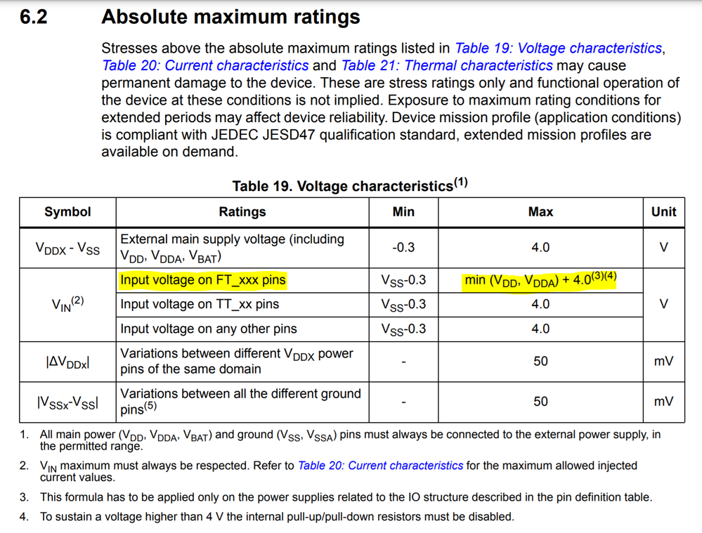

Does anyone have experience with 5V pull ups? do you have to power on the 5V source after the MCU is started?
I'm running a STM32L431CBT6  with external 5 volt 10k pull-ups on the pins PB11,12,13,14,15 and PA1. (all flagged as FT pins)
I've been able to plug it in and power it on and even program the MCU. All of the pins above are in "reset_state". So, as far as I can tell, we are not using any internal pull-ups/downs.
After some time and, perhaps, consecutive plug-ins, the chip seems to burn out.
I've since cut the chip off the board (since its burnt) and replaced with with a 47ohm resistive load and taken a measurement of the startup voltages (see attached image).
The blue line is the 5V rail, which is powering the pull ups.
The red line is the 3.3v LDO powering the MCU.
There is clearly a short time where the GPIO pin goes above the MCU power, and there is also about 1.6ms between the MCU powering on and the GPIO pull-ups getting over 4V.
According to the documentation DS11453 (Rev3) page 86, one should be able to put 2V on a GPIO pin to an unpowered MCU, you just cant put VDD+4V.
In previous designs, we have had an MCU activated a switch that allows the 5V to these pins after the MCU is powered up. In this design we have taken the switch out. However, there are other changes in the design that I'm also looking into, so I'm not convinced that this is the actual problem.
Is anyone aware of a reference design that demonstrates 5volt tolerance.
When unpowered (VDD=0), the max on any pin is 4V. So yes, you need to power it before you can apply 5V to a pin, per the datasheet.
But your powerup chart does not violate this condition, so that's probably not the issue.
 What exactly are the symptoms?
If you still have that specimen and can expose pins, you may want to check at least the protection diodes from individual pins to ground. It's not a definitive test, but it's cheap and easy and sometimes it reveals a potential problem with heavily abused pins. You can't test whatever positive rail protection there is for the FT pins, but you can test it on the TT pins.

> I'm wondering, why cant you test the FT pins like this?
The protection structure is not published, but imagine it's a Zener with breakdown voltage of around 6V against VSS (ground); but then there are also fine input transistors between the pin and VDD with breakdown voltage of cca 4V. So, if you'd want to measure that Zener while VDD=VSS (i.e. when the circuit is switched off), you would exceed that input transistors breakdown voltage and damage them. Typical diode setting on multimeter won't exceed output voltage of 1V so it won't even get close to the Zener's (or input transistors') breakdown.
Diode setting on multimeter typically sources 1mA, so if between VDD and VSS is 34 ohms (due to internal breakdown i.e. melted structures in the chip), that will result in maximum drop of 34mV - in other words, measuring pin against VSS vs. pin against VDD will result in roughly the same voltage and won't reveal any internal structure.
The idea of measuring the IO pins is, that should a damaging current have flown through the pin, it's likely that it either burned through the input bond, in which case you would measure no diode, or it damaged the protection diodes or the input transistors, in which case you would measure lower voltage than the diodes' against VSS or VDD. So you test all the IO pins, one by one. Would there be one or only a few such pins, you'd then examine the external circuitry associated with those pins. Of course this is no science and there are many other modes of failure which can't be revealed in such simple way, but this is cheap and easy and quick test and usually worth a shot.

As far as i can tell though. The FT protection would "probably"* only really cause damage out if it's a prolonged breaking of absolute max ratings. .. or rather, the total energy you put of the protection diode (or whatever is there) has to be great enough to actually heat it and break it. Especially in these lower voltage ranges**.

I would imagine that the diode when then be to the standard 3.3v VDD and that the diode would simply be able to just tolerate the constant current at the specified limit. Considering it might be a diode with at least an 0.7 voltage drop between the pin at 5v: that leaves just 1V through the 10k pull up resistor. The result is 0.1mA during normal operation. It also indicates a maximum of 0.5mA in the start up phase (some milli seconds), so I'm thinking it won't really get damaged, and that this is indeed an acceptable way to use the circuit.
And, by extension my issue might be somewhere completely different in my design.

I found here in AN4899 that this is fine to do, but they recommend a zener diode for transient protection.
https://www.st.com/content/ccc/resource/technical/document/application_note/group0/13/c0/f6/6c/29/3b/47/b3/DM00315319/files/DM00315319.pdf/jcr:content/translations/en.DM00315319.pdf
I have since done a lot of testing an have not been able to break my 3rd board. I'm thinking I must have just done something careless with the first two boards.
None the less, it is still "possible" that this was the issue since I was hot-plugging it a lot causing the possibility of these transients to occur.
I will add this transient protection to my final design.
