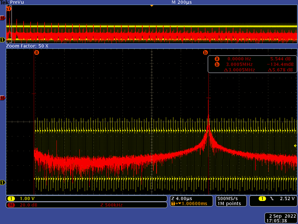

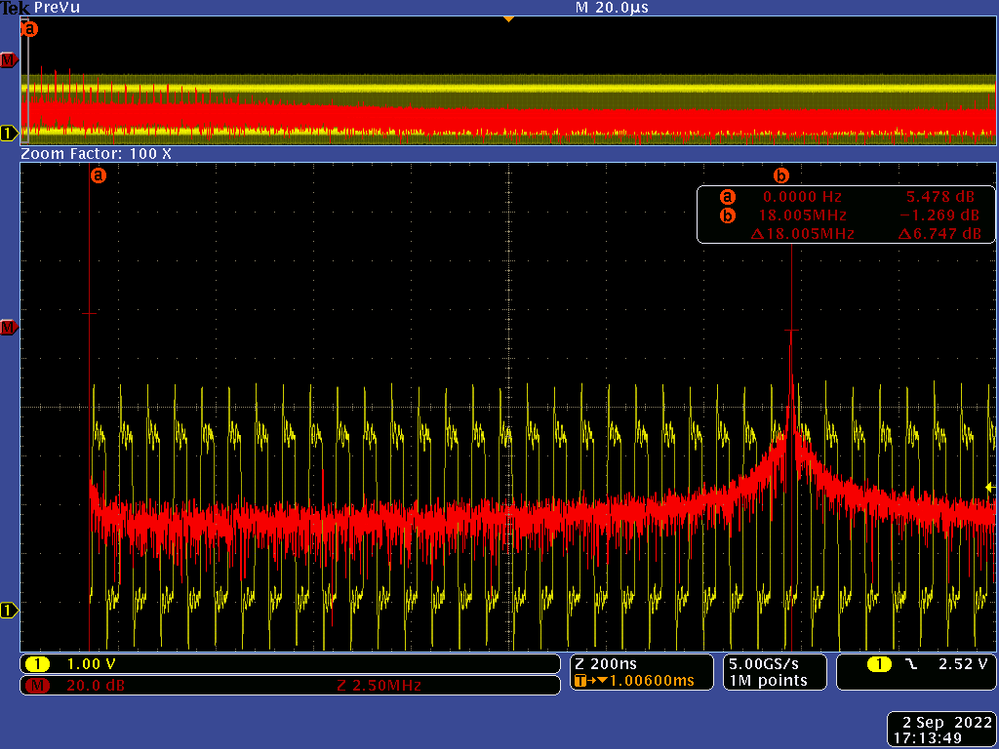

Just to check, this is what my scope gives me on MCO (PA/CN13-D9), when using SYSCLK on it. It gives nearly perfect 3MHz (24MHz/8). But the PLL1R is at 18 MHz, which means that the VCO has a frequency of 144 MHz, instead of the 132 MHz that I've configured (24MHz/2*11). What am I missing?0693W00000SuO9GQAV.png

Argh, found it N of 11 implies a divider of 12
 MODIFY_REG(RCC->PLL1DIVR,
               RCC_PLL1DIVR_PLL1N | RCC_PLL1DIVR_PLL1R, /* clear what we need */
               (11 << RCC_PLL1DIVR_PLL1N_Pos) /* VCO is this many times + 1 higher than its input frequency */ |
               (0 << RCC_PLL1DIVR_PLL1R_Pos)  /* post divider: value + 1 (?) */
