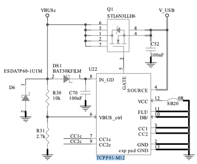

Probably I discovered the problem.
When CAD_Check_HW_SNK is called, none of conditions to change CurrentHWcondition to HW_Attachment is fulfilled. This is happening because CC1 and CC2 in WINBOX1 is not connected to STM32.
See schematic:
The question is then how can I put this working or do I'm missing something else?

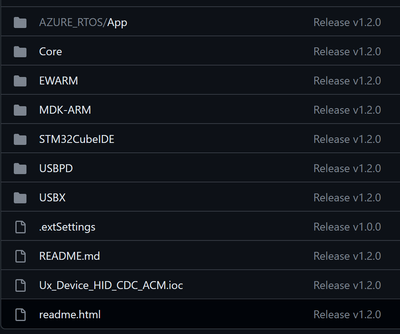

MM..1
Chief III
If you import some as new from ioc, then result is complete empty project with only hw config and libs.
Real usb or other projects need more files and advanced config in files , that isnt generated.
Use other right way to import project , i prefer unzip on some place without spaces in path and double click .project file in STM32IDE folder...
Following MM..1 indications, made changes in code but still unsuccessful. Just update zip file in github.
MM..1
Chief III
When you follow the you need see structure
i dont see it in your zip file
Opened the project from https://github.com/STMicroelectronics/STM32CubeU5/tree/main/Projects/B-U585I-IOT02A/Applications/USBX/Ux_Device_HID_CDC_ACM and also don't see your structure.
Compiled it successful. Made changes in GPIO for WINBOX1 and USB still failed (not recognised in PC).
See schematic:
