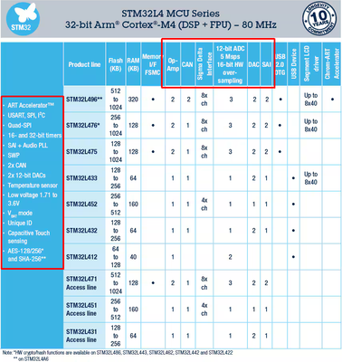

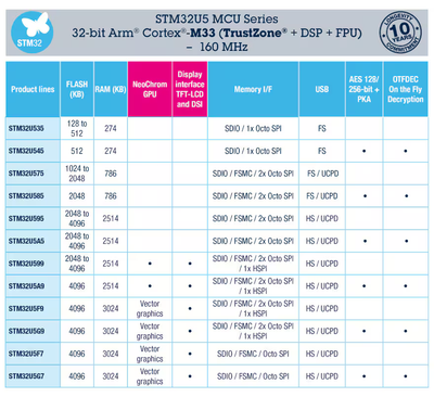

The older STM32-family infographics contained a fair amount of information about what to expect in terms of available peripheral mix from a given family and its constituents. The newer ones don't, forcing us to dig deep to individual model's pages and pdfs to painstakingly extract and organize that information. For example, for the new 'U5, we have:
whereas this is what is for the - roughly comparable - 'L4:
I've highlighted the kind of information missing from the 'U5's.
