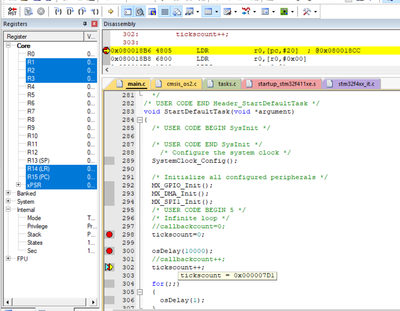

I have initialized the kernel first, and called HAL_Init() and SystemClock_Config() within the OS task - StartDefaultTask, the osDelay is not blocking the StartDefaultTask until the specified number of ticks.

Please tell us the rationale behind wait time being scaled when System Clock configuration and HAL are called after starting the OS Kernel.

Hi @cchan.3 Could you tell where have you found an example where HAL_Init() and SystemClock_Config() are called in a task, rather than before initialization of RTOS (by the way which RTOS you're using)?
‎2023-08-28 8:48 AM
I didn't find it anywhere. I am just trying to understand what happens when it is called inside a task.
‎2023-08-28 11:06 AM - edited ‎2023-08-28 11:07 AM
@cchan.3 As you see, nothing good happens. There are examples with RTOS, please refer to them.
