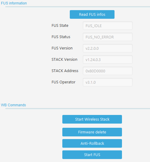

I updated The FUS of my STM32WB55 Nucleo Board to FUS v2.2.0.0 and the BLE Stack to v1.24.0.3
After this change Flash erase operations fail at the call of `SHCI_C2_FLASH_EraseActivity` with the error code `SHCI_FUS_CMD_NOT_SUPPORTED`
Additionally BLE does not advertise anymore.
The log from the `Read FUS infos` returns some warnings:
notably:
10:35:12 : Warning: Option Byte: nSWboot0, value: 0x0, was not modified.
10:35:12 : Warning: Option Byte: nboot0, value: 0x1, was not modified.
10:35:12 : Warning: Option Byte: nboot1, value: 0x1, was not modified.
10:35:12 : Warning: Option Bytes are unchanged, Data won't be downloaded

 How can I solve this issue?
Christophe Arnal
The CPU2 is currently running the FUS. You need to Start the Wireless Stack. This can be done from CubeProgrammer as you can see in your screenshot.

Thank you,
that worked!
Turns out I had done so, but to confirm, I always pressed `Read FUS infos` which seams to have stopped the wireless stack?
