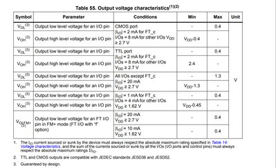

Hi @Gaston
Additionally, as @TDK mentioned,
You can refer to Table 55. Output Voltage Characteristics, which is found in the Datasheet.
Depending on the voltage you will use in your application, it provides the maximum current supported for the I/O.
Thanks.
ELABI.1
