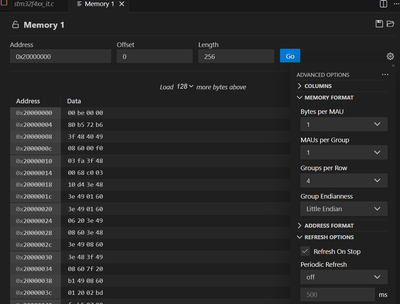

I wanted to inspect the memory using the built-in Memory View window in VS Code, but the option is unavailable even though the debugging is on at that time, and it says "Add a new view using the plus button in the Toolbar with the debugger paused. Supported debuggers: cspy, cortex-debug, cppdbg."
Is this a limitation of the current ST-Link GDB debugger in STM32 VS Code extension version?

@rowellsa
You're not relying on proper memory view.
Right one is :
You're on :
Let's check CDT one is installed and call it Thanks (takes care this view is only available having a debug session active)
Cartu38 OpenDev
Graduate II
December 10, 2025
Has to look like

@MGogr.1 not sure to understand your question here. Yes i'm able relying on CDT extension. I've shared snapshot of view running above.
