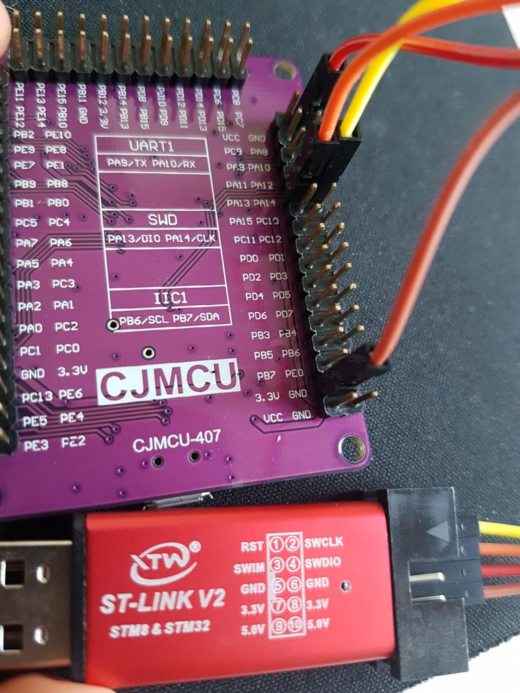

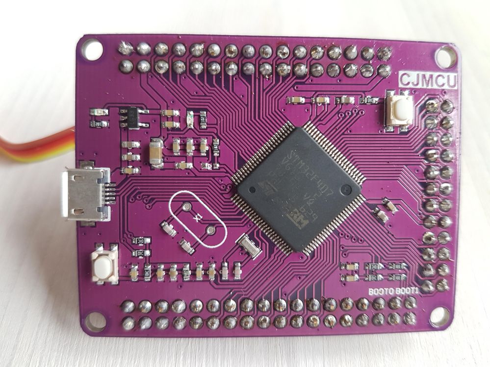

Hey,
I have recently bought the CJMCU-407, but I'm not able to let any LED blink... does anyone can help me out there? 0690X00000603qOQAQ.jpg0690X00000603qYQAQ.jpg
#stm32f4 #cjmcu #pin-map

Posted on May 18, 2017 at 18:56
PE0
Posted on May 19, 2017 at 09:57
Hey,
thank you for your answere. But, if I define everything for let that LED blink, nothing happens. Are there more than one connected? The LED next to the OTG-power supply is always enlighted, even if the chip is blank.
Where did you got that information from? Is there any datasheet for that board? I haven't found one, neither the factory.
Btw. maybe I'm wrong but this shall do the blinking start? *attached*

Posted on May 19, 2017 at 10:05
Look at the picture you gave, it's connected to pin 97.
Try to exercise it in the debugger - after having enabled GPIOE clock in RCC, set GPIOE_MODER bit 0, then toggle GPIOE_ODR bit 0. Measure output voltage directly on the pin.
