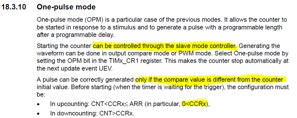

I'm using STM32F429x. I'm confused by the 'OCx fast' setting when using the 'One-pulse mode' of the timer. In DM00031020 section 17.3.15, it states:
In One-pulse mode, the edge detection on TIx input set the CEN bit which enables the
counter. Then the comparison between the counter and the compare value makes the
output toggle. But several clock cycles are needed for these operations and it limits the

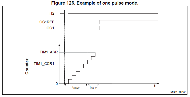

''But several clock cycles are needed for these operations...., it limits the minimum delay tDELAY min we can get'', I think it means if we don't enable OCx fast setting, we will get a delay. However, I don't understand where the delay will appear in the figure above?
Anyone can explain the situation more clearly? What we can benefit from enabling �OCx fast'????

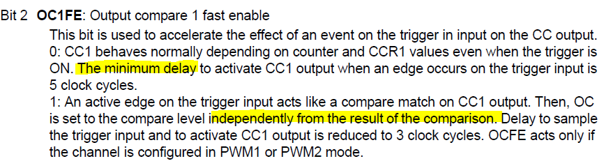

Here is the OCxFE  flag

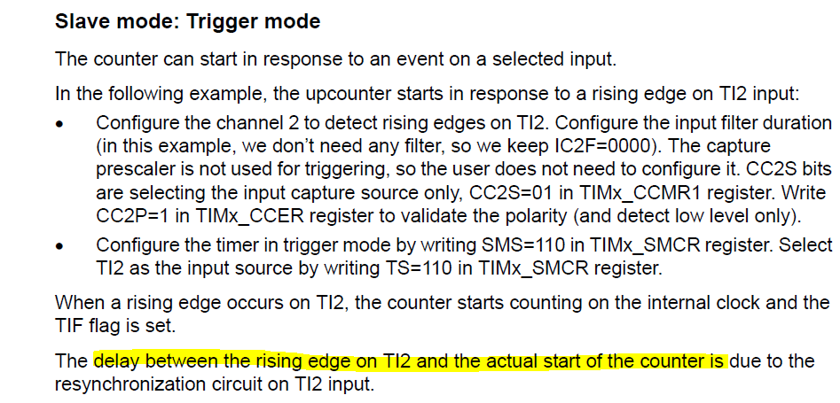

here is  explained that the one pulse mode is part of slave functionality
and here is explained that this delay is due to the resync cirquit(slave functionality)
An interpretation could be The minimum delay from trigger to output  is 5 clocks from internal delay  plus one counter period (PreSCaler involved)
So if you want to trigger a pulse ''right now'' in one pulse mode  , you must wait 5clcks +1 counter period.
In this case you can minimize the delay by set the OCfast bit, to 3 clocks only. (and no one counter period )
Regards
vf
Posted on September 01, 2017 at 05:52
Thanks for your detailed explanations.
Let me make sure:
  1. When OCxFE = 0: Becuase CCRx must be greater than 0, so the minimum delay is 1 counter period. And plus the 'inherent' delay of STM32, the minimum delay between the trigger and our desired pulse we can achieve is 5 clocks + 1 timer counter period.
  2. When OCxFE = 1: The CCRx value is meaningless now, because the '
    comparasion
    ' is  bypassed now. And the
    minimum delay between the trigger and our desired pulse we can achieve is 3 clocks.
