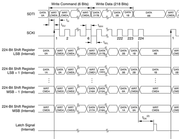

. It is even propagated to SCKO and SDTO. To be honest, the signal SCKI is perfect on the inputIn order to give the right parameters, I have to send the 224 bits register, with the first 6 MSB being 0x25. This is the write instruction who actionates the latch.
I feel maybe the SPI1 of my STM32f4 is not doing the job, because I don't have pwm. At the end 8 cicles scki should be down for the tlc5971 to produce the latch and register the parameters.

‎2017-08-31 12:23 PM
Without latching, send a bunch of data, like 2x224 bits or more. Observe the data on SDTO with a LA and compare whether they match the input delayed by 224 clocks.

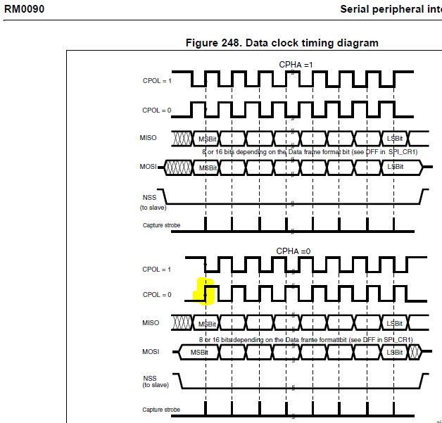

hello!
>>>> SPI : ( slow baud rate; 125Kbits/s; CPOL Polarity Low; Phase CPHA: 1 Edge)
TLC5971 manual
RM for MCU
so CPHA must be 0
>>>> HAL_GPIO_WritePin(MCU_SCKI_GPIO_Port,MCU_SCKI_Pin,GPIO_PIN_SET); /// I set the SCKI High so
/external-link.jspa?url=http%3A%2F%2Fwww.ti.com%2Fproduct%2FTLC5971
creates the latch and register.Is your intention to use a GPIO set function when your pin is configured allready as AF (SPI SCK)?
Actualy there is no need to pull SCKat HI state.
The above figure from TLC5971 manual, shows to keep the SCK at low state for a tD6 time. (introduce some delay tD6 after finish transmission)
Note : with CPOL =0 , the SCK polarity after finish the transmission, is allready low.

‎2017-09-01 3:15 AM
Hi Vangelis!
I use
Phase CPHA: 1 Edge; which means CPHA=0;
Maybe I'm wrong, but usually 1 Edge -> CPHA= 0
2 Edges -> CPHA =1
Best Regards
‎2017-09-01 4:40 AM
Hi again.
I wrote ' so CPHA must be 0' You use CPHA=1. I do not agree
