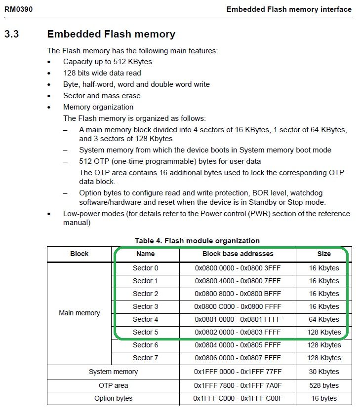

How many sectors does the flash memory of stm32f446rc has and what is the size of each sectors ?
Same die, up to 512KB

RM0390
Reference manual
STM32F446xx advanced Arm®-based 32-bit MCUs
is your friend.
That Reference manual has details for 512 KB flash memory only ...not for 256 KB flash memory.
