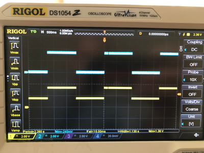

Here is the output I am seeing.  Blue is GPIO_11/PA7 which is working correctly.  Yellow is GPIO_23/PA8 which is not falling close enough to GND.
Suggestions?

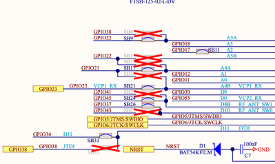

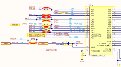

It appears that pin is connected to VCP1_RX:
Coopdis
Yes!  I see that in the schematic.
That said, a search for "VCP" in the reference manual turns up "0" hits.
It seem to have something to do with a UART... which I am not using in anyway... except perhaps as a debug interface?  But if it PA8 was being used for some debugging communication I would expect to see it wiggling, or for debugging to get screwy when I tried to toggle the PA8 pin. I don't see any of that.
So, I guess the question becomes, what is VCP_1RX, and how do I get it to stop messing with my PA8 pin?

Coopdis
Huh... remove SB21?
Perhaps I am looking at the wrong document?  I have been referencing this document...
https://www.st.com/resource/en/schematic_pack/mb1863-wba52cga-a03-schematic.pdf
On the 3rd page is the following diagram...
I'm still pretty new to STM32 but in my reading, this seems to show that if I remove SB21, then PA8 will no longer be connected to GPIO23?  It does not appear to indicate that the influence of VCP1_RX on PA8 will be effected at all?
Would you please explain a bit more about how removing SB21 would address this issue?

Chris21
Senior III
Well, that schematic is not too clear, but it looks like removing SB21 could disconnect PA8 from everything; you should be able to confirm that looking at the actual board.
Removing SB17 and adding SB19 will connect PA8 to GPIO21.
Ah, okay!  That did it.
I guess it seems the Nucleo board is doing something on GPIO_23 that is not documented in the schematic?
It seems that I maybe could have also removed SB5 to disconnect VCP1_RX from GPIO_23.  Digging further, it is clear that the VCP1_RX has something to do with the STLink, but what exactly is still unclear to me.
Regardless, debugging still works and GPIO_21 is now working as expected after the re-configuration of the solder bridges as you suggest.
Thank you,
Bill

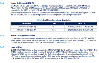

Chris21
Senior III
I believe VCP is a feature where a virtual COM port is produced by the STLink that allows your micro to send data via USART pins (e.g., PA8) which appears at COMx on your PC.
The user manual describes this, somewhat:
