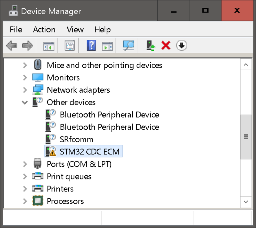

I am progressing on porting the CubeU5 project for STM32U575I-EV as Ux_Device_CDC_ECM to a NUCLEO-U575ZI-Q board:
The USB enumeration seems to work: I hear the sound and I see also an USB "STM32 CDC ECM" device.
BTW: very important to go with the right BSP files: the NUCLEO-U575ZI-Q has a different USPD chip! (I have changed to the right BSP files for NUCLEO, the EVAL board BSP cannot work).
What I get:

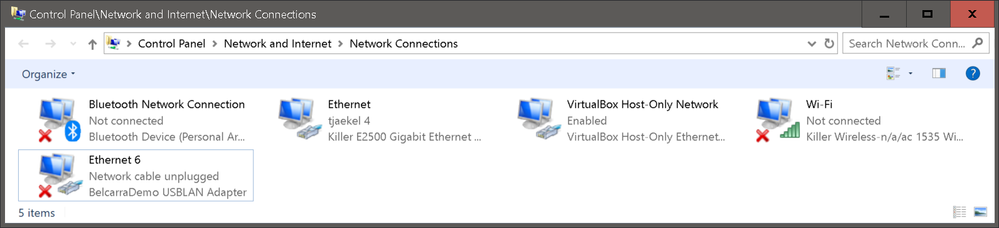

  • an "Other devices" in device manager (the driver is not found):
No idea what to install on a Windows OS to make the device driver happy.
What works:

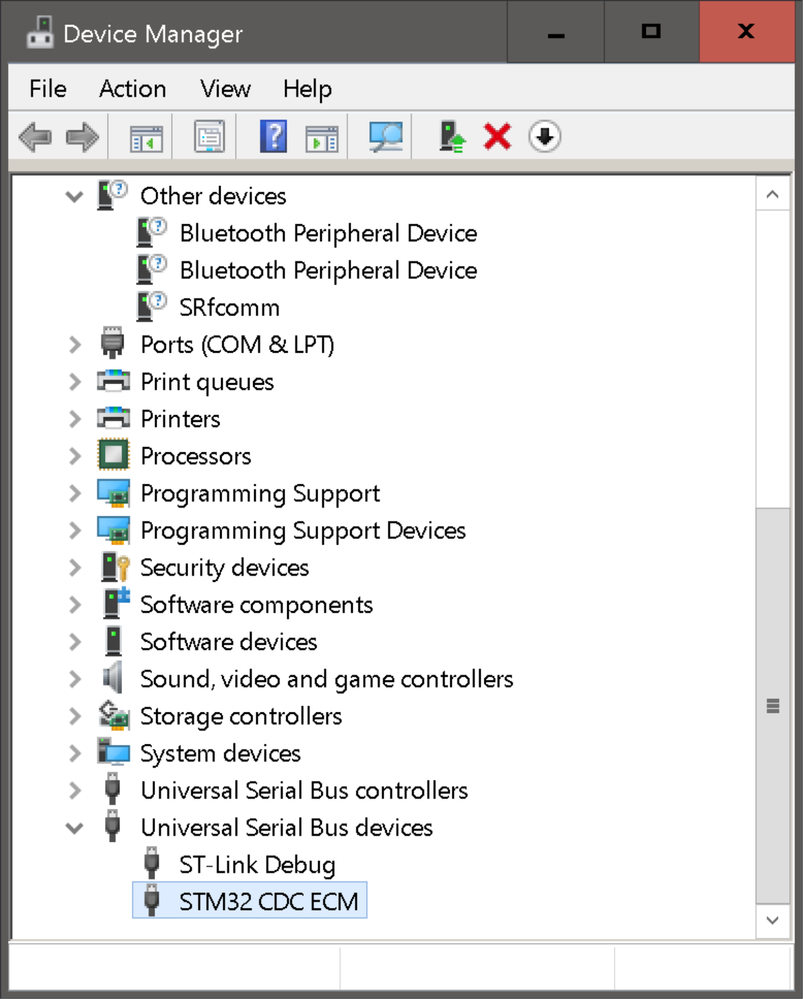

  • if I select manually and select "USB devices", "STMicroelectronics" and "STLink Bridge" - the driver is happy
  • but it cannot be right (it does not look like a network interface is added to the system)
  • trying some NDIS and RNDIS drivers fail (Windows complains about issues to install)

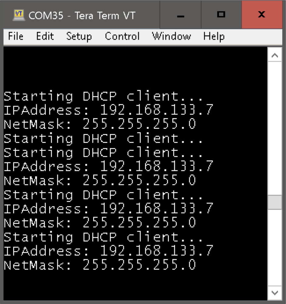

The MCU FW is not happy:
  • it does not progress on DHCP server: the MCU does not get any IP address (and the event for IP address changed is not coming)
If I try on a MacOS:
  • it looks like I see a new ETH network interface: an "en4" is there when I have connected the MCU board (via USB and FW running as USB ECM, without MCU it is not there)
  • but the FW does not progress here in the same way: it does not get an IP address via DHCP
  • I tried to ping the reported IP address on "en4" - it does not work

What is missing so that MCU FW gets an IP address (via DHCP, as enabled in FW)?

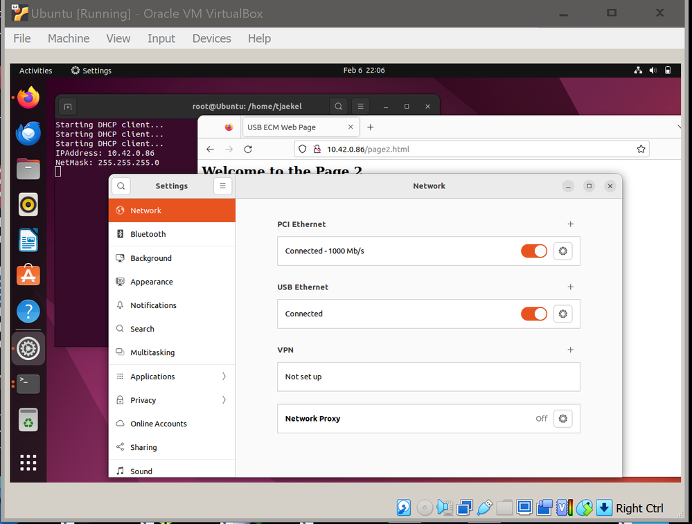

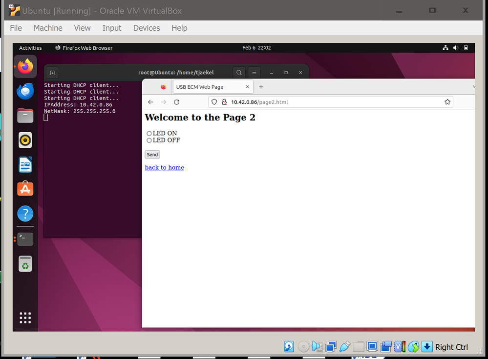

  1. A host (Linux, Android, MacOS) could connect and control MCU board via TCP/IP (network) - even the MCU board is just connected via USB (and does not have ETH connection).
  2. Running my (Android) phone as "Mobile Hotspot" - the MCU would get access to Internet, or I can access the MCU via WiFi - even the MCU board does not have a WiFi chip,
  3. I can reuse my host scripts, e.g. Python, talking via network (TCP/IP, UDP sockets) like to my other MCU boards.
How to solve the issue with missing USB ECM driver on Windows?:
  • STM could think about to provide a Windows driver - would be very kind. Thank you.
  • Install a Virtual Machine (VM) on Windows, running Linux (e.g. Ubuntu) and try if USB in VM would see it as USB ECM.
So far, all accomplished what I had in mind.

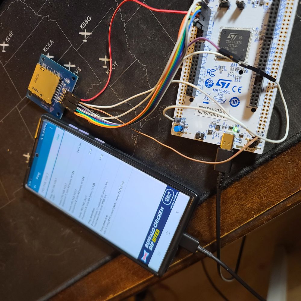

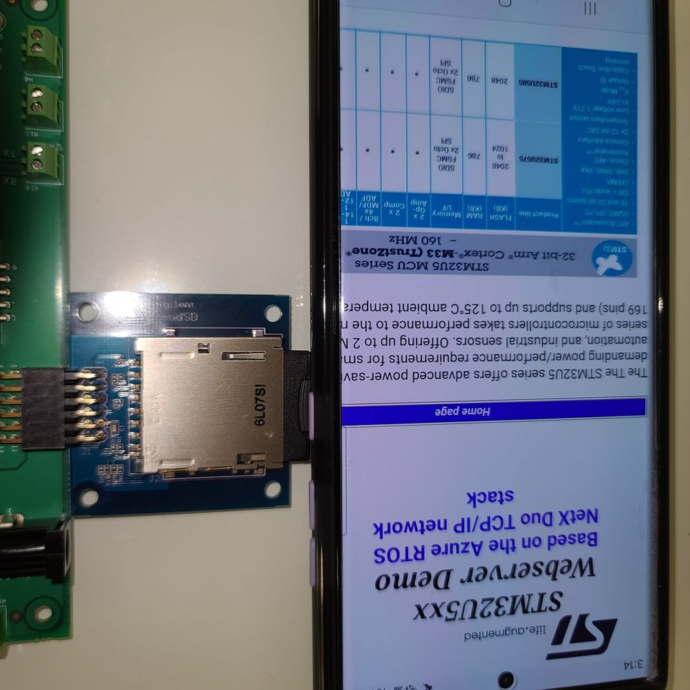

Another progress: I can see my NUCLEO-U575ZI-Q board on an Android phone! Cool.
What I have figured out on Internet:
  • USB EMC is NOT supported by Microsoft OS: you would need a special vendor driver (and I could not find any USB EMC driver, STM does not provide any...)
  • (only) RNDIS is supported by Windows (very old), but it is not the same as USB EMC:
    all the RNDIS drivers I tried to install - FAIL (on my Windows 11 PC, "driver cannot be started")
  • I do not want to go with RNDIS (too old, hard to find STM32 examples, all new Middleware with AZURE does not seem to have RNDIS): it would need anyway a different USB stack on MCU board (and hard to find one, just very old stuff, not for my MCU...)
But USB EMC works fine on Linux, e.g. MacOS, Ubuntu Linux (not tried) but for sure on Android!
So, I could enable "Ethernet tethering" on my Android phone:
  • I can enable - a very good indication: it means: the USB EMC is recognized (provided by my MCU)
    (if MCU is not providing an USB EMC or it is not connected/not running - not possible to enable - great to see it works)
  • I can also "ping" the IP address (reported on ST-LINK UART) - works
Just: my SD Card interface or the SD Card seems to have a problem: the file system, to initialize and to open the request files (e.g. "index.html") does not work.
But the USB EMC is working! Cool
When I connect via USB-C to Android phone, enable "Ethernet tethering" - the MCU progresses, gets an IP address (via DHCP server) - cool.
I can also "ping" the MCU, via the IP address on UART log (ping tool on Android phone, I cannot reach MCU from PC: a different network, potentially a "route" setting needed, with a gateway to reach the other network)

Issue with SD Card solved:
The flying wires were causing the issue to open the web files. With a carrier board where SD Card adapter is connected - all works fine. BTW: I tried to lower SDMMC speed, clock dividers - nothing helped really, except to make the connection "directly" for SD Card adapter (I got CRC errors on SDMMC transactions).
So, all works fine (on my Android phone). Just Windows OS "sucks" (missing driver).

Great that you found a CDC-ECM driver too for Windows. Very useful.

For anyone coming here due to interest in ethernet/IP over USB, I'll note that TinyUSB has support for ECM, RNDIS, and recently added an NCM impl as well. Their maturity varies,  but at least there's active development around it.
Windows 11 ships with a microsoft driver for usb NCM devices.
