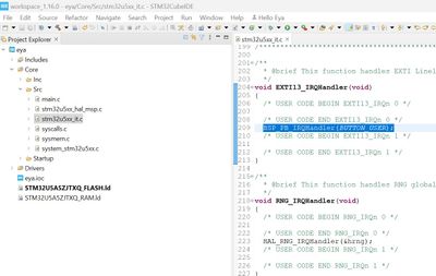

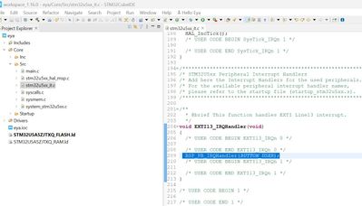

Hi @DenzilDexter,
I reproduced the same example that you did and I didn't have any problems after enabling RNG.
Here is a screenshot before enabling RNG:
and her is a screenshot after enabling RNG:
I think you should update the version of CubeMx that you are using (the latest version is 6.14.1).
Thank you.
