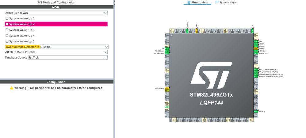

This are the settings on the ioc project file:

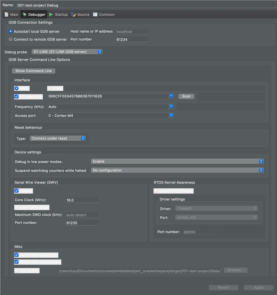

And this are the settings on Debug configuration:

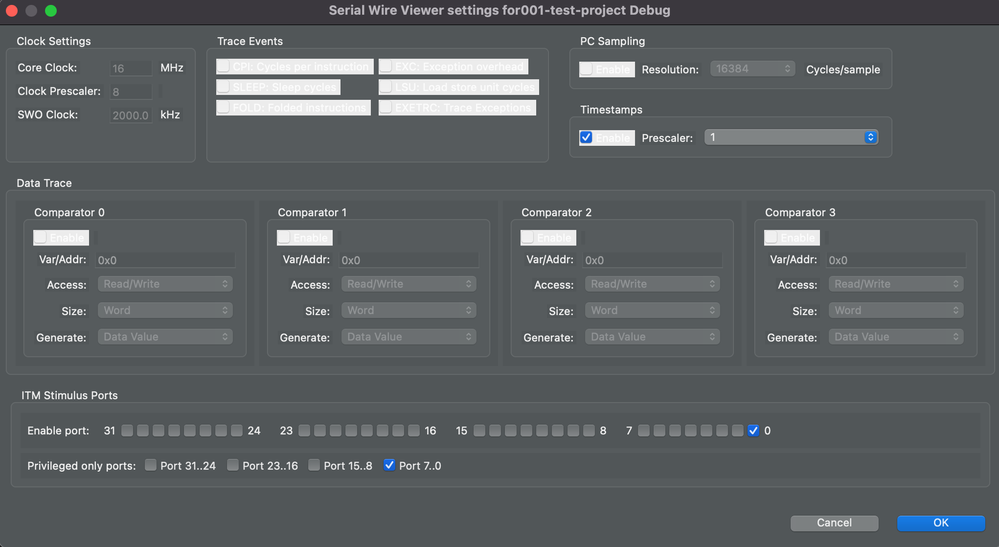

And the ITM settings:

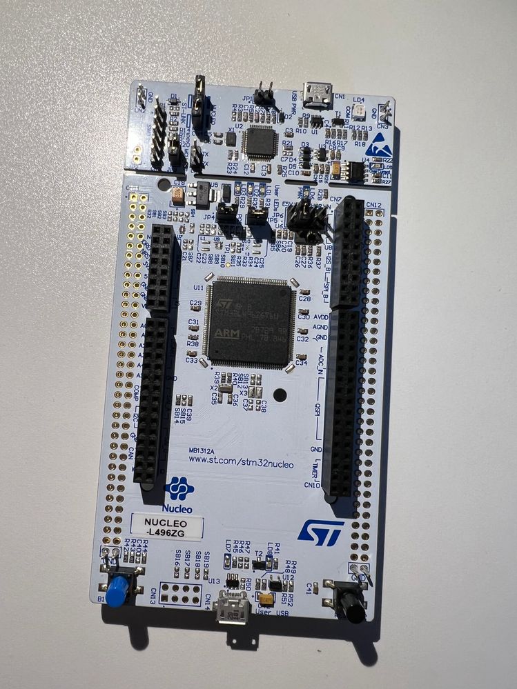

0693W00000QO4zFQAT.pngThis is my board:
PB3 is connected to SWO.

And you're clocking the MCU at 16 or 80 MHz?​
3 REPLIES 3

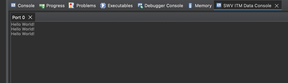

That was the issue. Thank you. Didn't set correctly the clock on IOC settings. Now is 16 MHz and it works.
Thank you very much!
